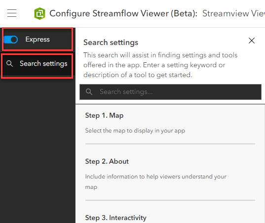

- Header —Choose to include or not include a header in the app.
- Basemap toggle – Choose a basemap to switch to
- Theme settings—Change the app's appearance by applying dark or light mode, adding a logo to the header, and using custom or predefined colors to style specific elements.
- Basic map navigation tools —Include Home, Zoom tools, Legend, or Search in the map.
- Sharing—Add options for app users to share the app. If a stream’s popup and chart are open, the app will be shared with that specific stream. Optionally, include embed and social sharing.
This is not a complete list of available options. Disable express mode and/or use the search settings option to find additional options.

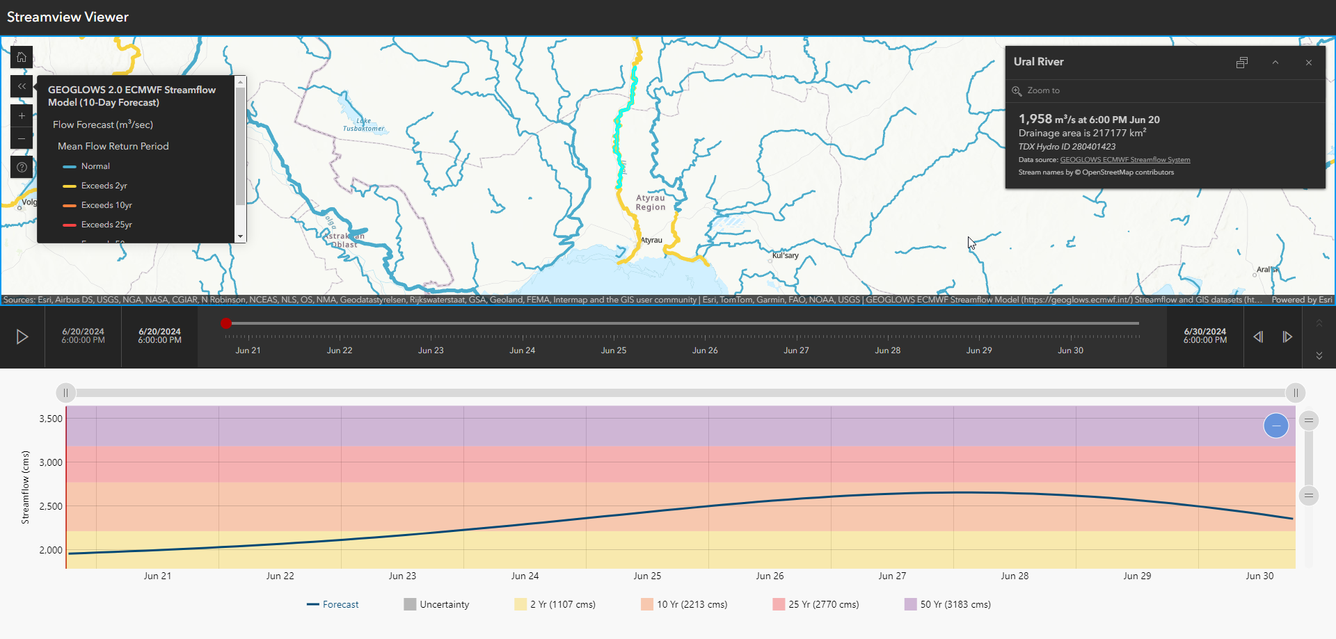

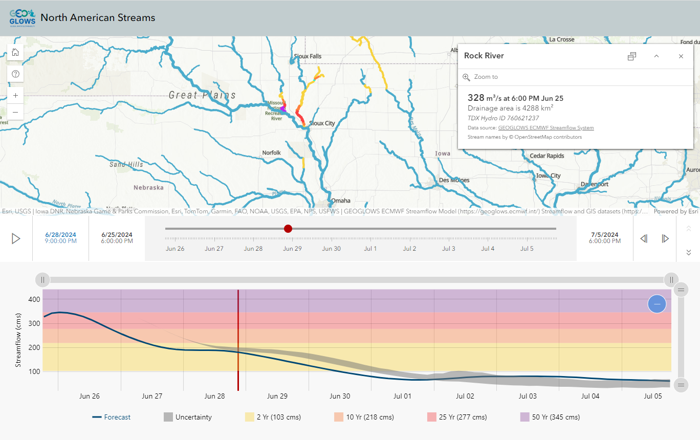

Interact with the graph and time slider.
Clicking on a stream segment will generate a graph of the segment. The graph uses the same 10-day forecast at 3-hour intervals described above for the map. The mean value of the forecast is shown in blue, and a probability range is shown in grey. The range is the 25% to 75% values of the 51 ensemble members. The return period colors and values from the streamflow service are also shown as the corresponding background color of the graph.
Use the time slider to animate the forecast on the map and the graph. The streamflow forecast service will update as the slider plays.
