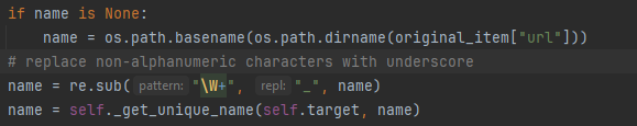

Indeed, the clone function checks if the 'name' property of the item to clone is None, but doesn't check the empty string case, hence the crash :
To sum up : I am unable to clone items that have transited through a collaboration, because of their 'name' property that has been transformed from None to ''.
