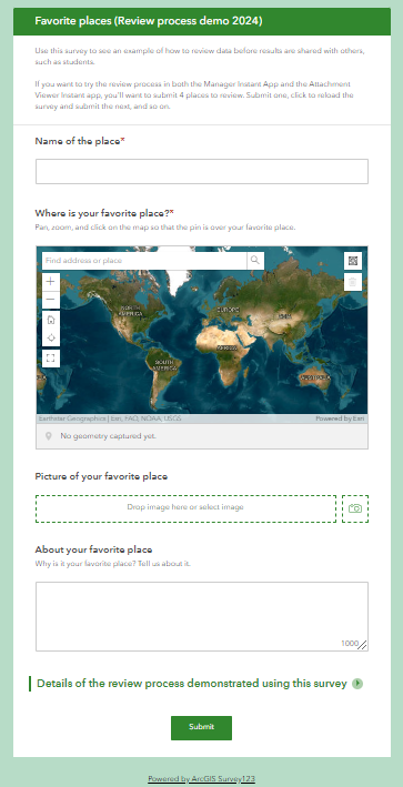

- Students collect data through a survey.
The survey is configured to mark all data as submitted, using a review status attribute field that's hidden from the survey.

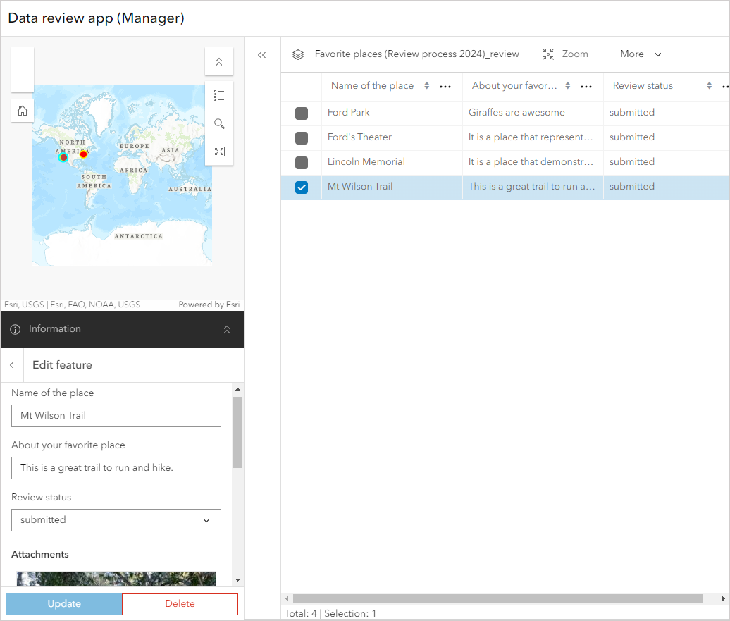

- Teachers and other designated individuals review the submitted data.
They mark each entry as approved or rejected by updating the review status attribute.

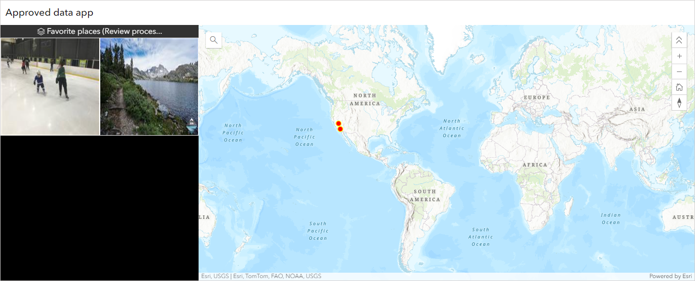

- Students use the approved data to answer questions and solve problems.
How and where they use it depends on what they need to do - you'll configure an app that meets their needs but is restricted to the approved data.
