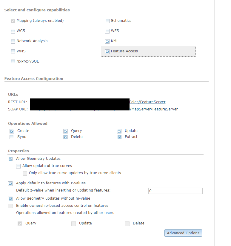

Any suggestions on why I can't edit a layer in 4.11?
I used the basic code in the Editor widget sample, swapping out a layer from a published service. Below are the settings on ArcGIS server, seems like they should allow for editing. The map and layer loads but the editor widget does not display. Any idea why the Editor widget isn't showing up?
