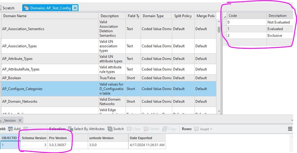

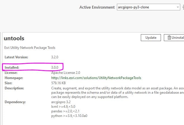

This is so confusing. I have ArcGIS Pro 3.0.3 with untools package 3.0.0 currently installed in my py3-clone active environment
After exporting any utility network to an Asset Package (which shows as Schema Version 3) I'm expecting to see the newer configuration categories ("AP_Configuration_Categories" domain values) per the 2.9 release notes.
3: Remove when applied.
4: Always remove when applied
5: Keep when applied
6: Always keep when applied
If I'm already beyond the released version, what happened? Why don't newer versions of untools have these codes that were already added in previous releases? I need to have all these options for testing D_Configuration and removing items. Must I upgrade Pro? I don't think I'll be able to install a higher version of untools until my Pro is upgraded. The problem is that we have an organization standard for Pro, so I'm hesitating on going this route unless absolutely necessary.
