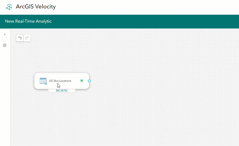

Once the feed is created, it would need to be added to a real-time analytic. This can be achieved from the feed details page button “Add to new analytic”, or by opening a real-time analytic and adding a feed from the “Add Node” toolbar.

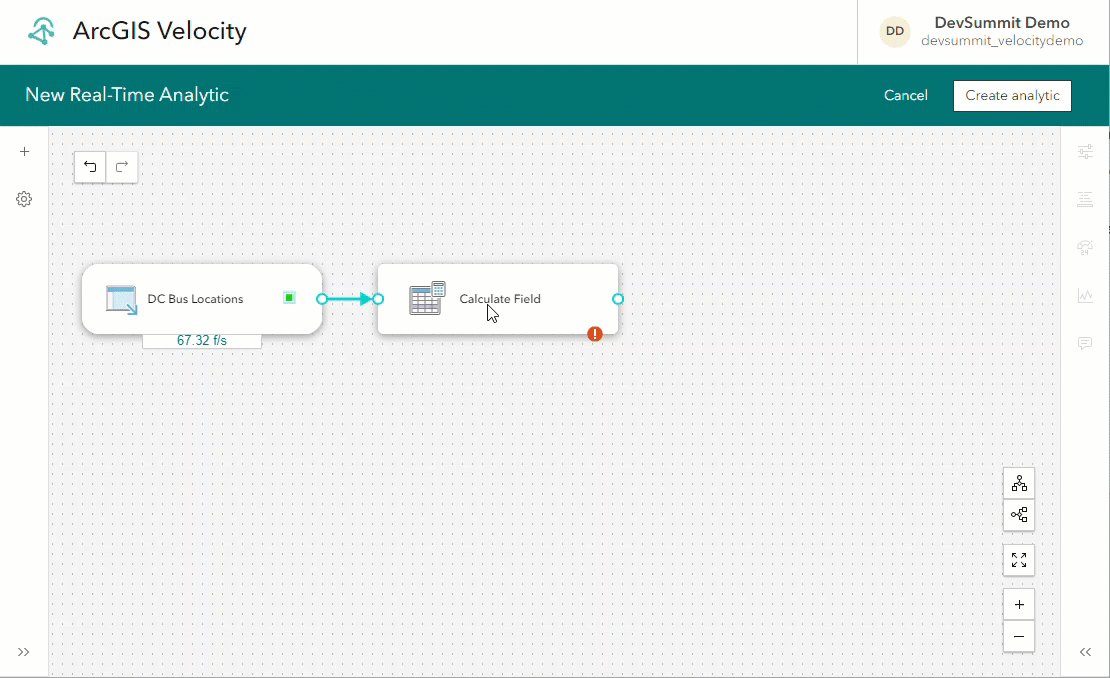

Step 1: Add the Calculate Fields tool and connect it to your analytic
Click the “+” button on the left pane of the ArcGIS Velocity real-time analytic, and then expand the “Manage Data” folder, and click the “Calculate Field” tool. This will add a disconnected “Calculate Field” tool present on your analytic canvas. Drag the tool to the desired location, and then drag the output port from a feed or upstream tool in your analytic to connect to the target port of the Calculate Fields tool.
Step 2: Configure the Calculate Fields tool to add a geometry expression
Now that the Calculate Fields tool is connected, double click (or right click > view properties) the tool to open the tool properties pane on the right. Next, click “Add field calculation” and select “Geometry”. This will open the geometry configuration where you can control spatial reference and provide the Arcade expression. Click “</> Configure an Arcade expression” to open the Arcade interface.

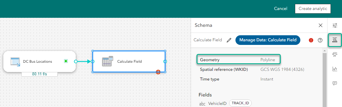

Once you have provided this Arcade expression, click “Run” in the top left to test and evaluate the expression. If everything is configured correctly, the output will be “geometry” type of a polyline. You can then click “Ok” to return to the Calculate Fields tool, click “Add field calculation”, and then “Apply” to save your changes to the tool.
If you click the schema tab on the right side of the node properties pane, you can now see that this Calculate Fields tool is generating polyline geometry.

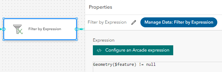

(Optional) Filtering out features with null geometry
Recall that on line 13 of our Arcade expression, if there weren’t enough features present for a given Track ID to generate our polyline geometry, we simply returned a null geometry. Many organizations would want to discard these features to ensure that there is not a mix of features with and without geometry causing confusion in later tool processing, analysis, or application experiences.
To get rid of these features, add a “Filter by Expression” tool after your Calculate Fields tool. Configure an Arcade expression such as below, where only features that have a geometry that is not null are retained. The expressions provided to the Filter by Expression tool need to result to a Boolean: true or false, and the features which evaluate in the expression to true are passed to the next step of analysis.
Geometry($feature) != null

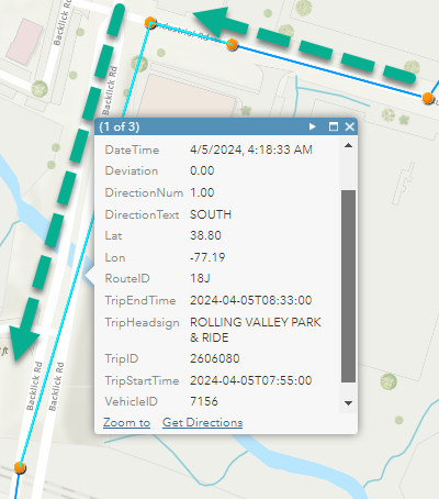

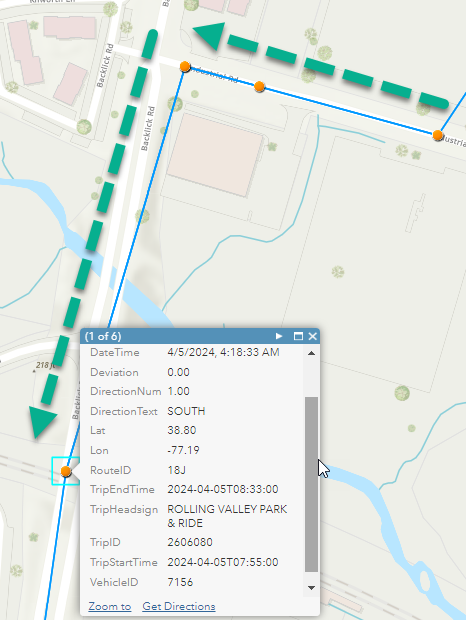

Let’s take a quick look at the result. Originally the real-time data was point geometry for each track representing city buses in the Washington DC region. For additional context, green arrows show the buses direction of travel. Note that this feature observation DateTime value is at 4:18:33 AM
Next, we can click on a polyline which was generated by our Arcade expression. It has the same attributes as the vehicle point above, however the geometry was changed to a polyline. In this polyline the vertices are created in order from the older historical observations for the track towards the more recent observations.
