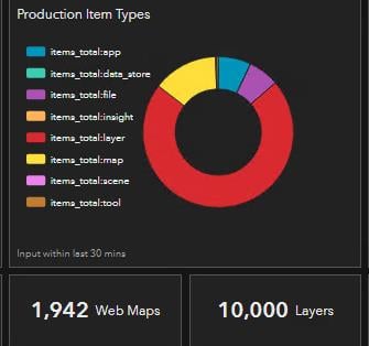

1. We have more than 10000 layers on the portal, and on the dashboard, the value is capping at 10000 only. Below is the screenshot for the same:-

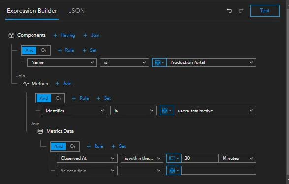

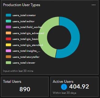

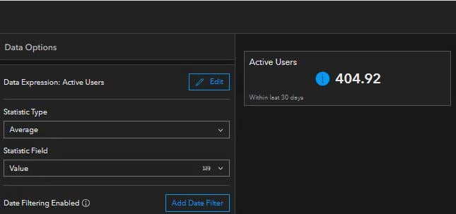

2. We have identified that sometimes the value of Active users and Total users is shown in decimals. I am attaching the screenshot of the data expression we have used.
