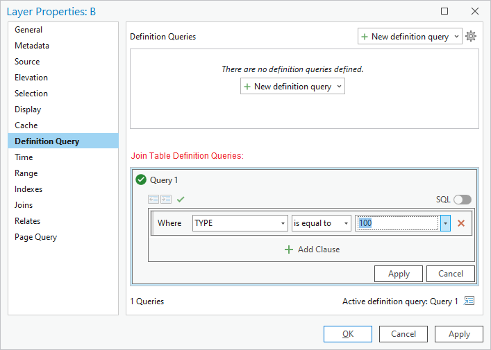

Could that behaviour be changed so that the definition query on the join table remains independent (as a pre-filter)?
Maybe something like this:
