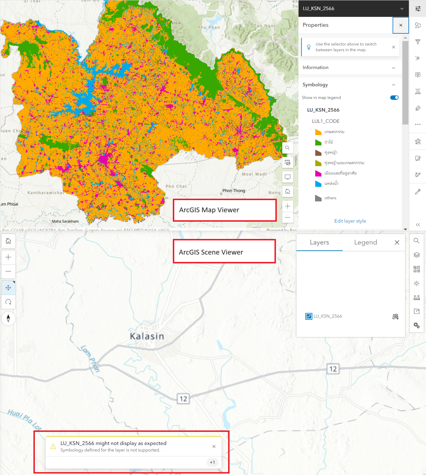

To enhance data visualization and user experience, I advocate for the comprehensive compatibility of feature layer symbols published from ArcGIS Pro within Scene Viewer, guaranteeing their consistent rendering and functionality.
The symbol settings for the data are already set in ArcGIS Pro, but when you want to use them in Scene View, you have to set them up again every time.
This means that when you create a map in ArcGIS Pro and add it to a scene in Scene Viewer, the symbols used to represent the data may not be the same as the symbols used in Map Viewer. This is because Scene Viewer does not support all of the symbol properties that are available in ArcGIS Pro.
As a result, you may have to manually set the symbol properties in Scene Viewer to match the symbols used in Map Viewer. This can be time-consuming and tedious, especially if you have a large number of layers.
