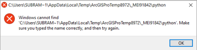

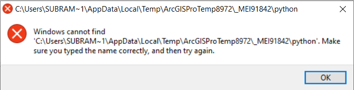

New user to ArcGIS pro. I
- installed 3.2.0
- opened Package Manager
- cloned the arcgispro-py3 environment as arcgispro-py3-clone
- click 'Add Packages'
- install 'Spyder'
and I am hit with the following error before installation is complete,
I click 'OK'. Spyder completes installation, but won't open.
