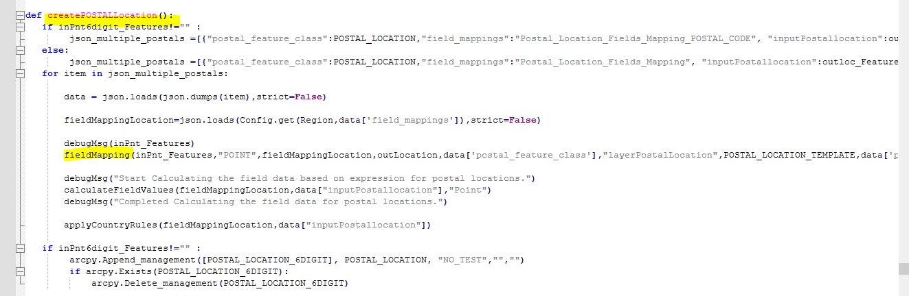

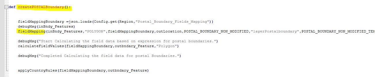

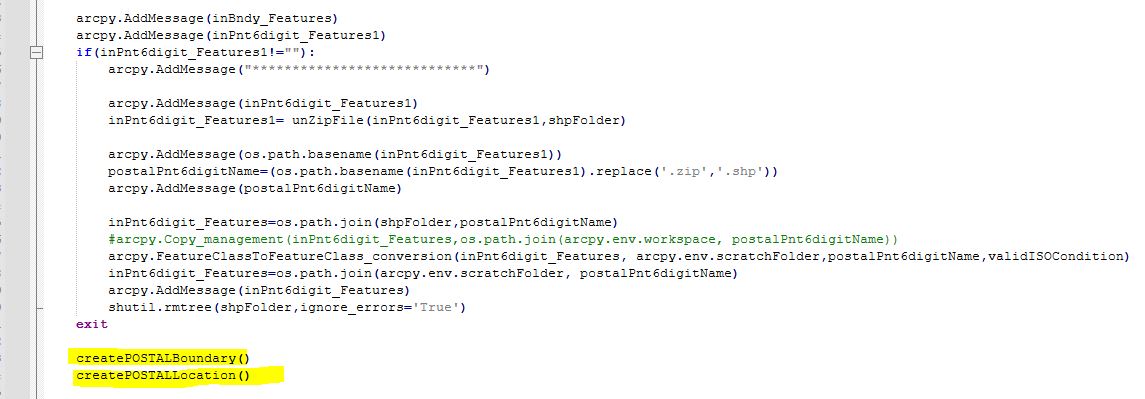

I have the gp service code which written in arcpy, with this code we are processing different countries but for only CANADA country its postal code truncating from 6-digit to 3-digit. we are having 3 .shp file from there we are extracting data and pass as a input and updating attribute table as target field POSTAL_CD in arcgis pro Please find the attached screenshot and specific code. In our code we are having createPostalBoundary() and createPostalLocation() inside this two function we are calling below function. Thank You
