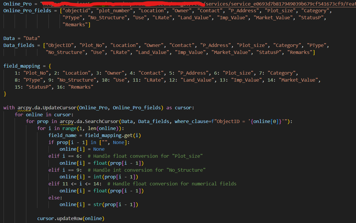

Hello there, I have a feature service that is published on my ArcGIS online account, and I have an Excel file with related data that I want to update the feature service with. I tried to update the feature service using the update method provided by ArcGIS online, but I received an error. Then, I tried another approach using ArcPy, and you can see the code in the attached photo.

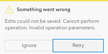

It worked successfully. After that, I tried to add a feature manually in the ArcGIS map viewer, but it didn't work. Since then, I have been receiving this error and can't add any new records from ArcGIS online. I am only capable of adding new features through ArcPro.

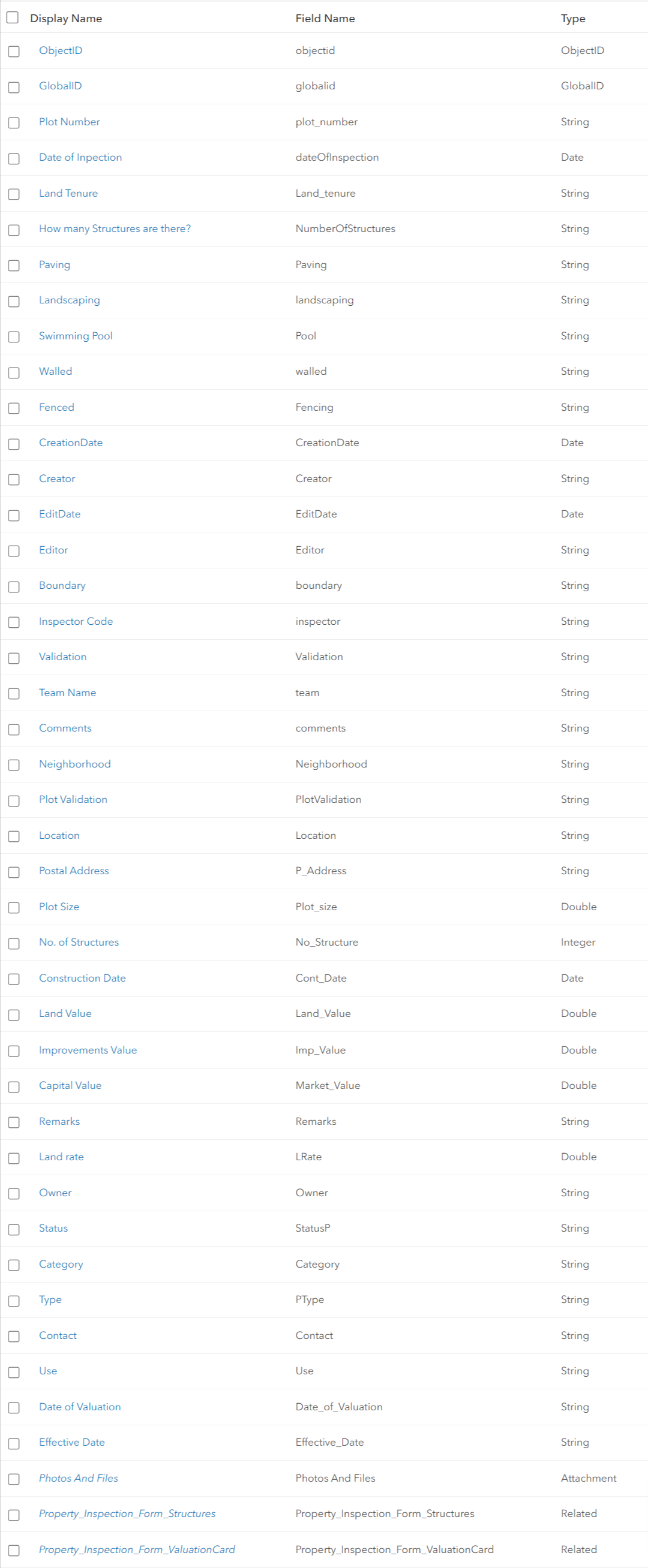

Here is the schema for the point feature service that I am having trouble with.
