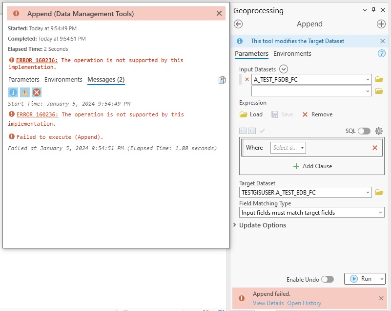

I think I slightly misunderstood this limitation when I originally posted it. The limitation exists whether or not the database is a geodatabase or not. The append tool can't be used on an unregistered FC, regardless if the database is an enterprise geodatabase. This problem isn't related to the Oracle database version.

ArcGIS Pro 3.2.1; Oracle Express 18c; the database is not a geodatabase (no ArcGIS Server or Enterprise)

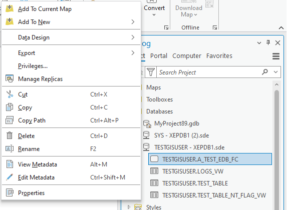

In that environment, I’m not able to edit data, because editing is only supported in FCs that are registered with a geodatabase: Unable to edit a feature class not registered with the geodatabase. I suppose that is expected.
I am able to create/edit data in a separate data source, such as a shapefile or mobile/file geodatabase, and then copy/paste the FC into the enterprise database using Catalog.
That works, but it would be helpful to have an additional option: Append external data into a FC in the enterprise database to avoid recreating the FC. Currently, the Load [Append] Catalog context-menu option is not available for enterprise database FCs. And the Append GP tool throws an error: "ERROR 160236: The operation is not supported by this implementation."
