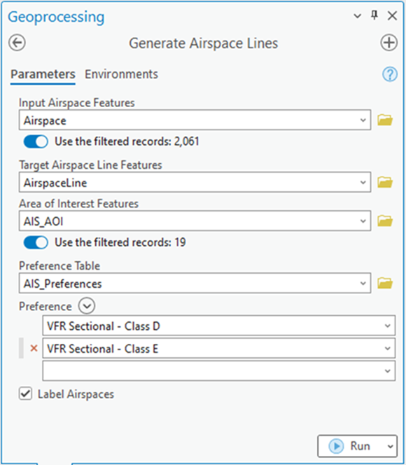

Process multiple preferences all in one run
This tool now supports selection of multiple preferences that can be configured to process different groups of airspaces all in one run.

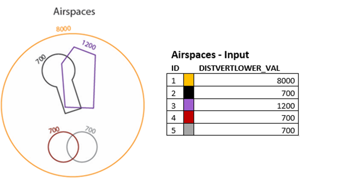

A new Label Airspaces option changes how the Airspace lines are generated and labeled to contain information from neighboring intersecting airspaces.
This allows you to now form a continuous line with similar intersecting airspaces as seen with Airspace lines f and g below.
After the five airspaces are processed through Generate Airspace Lines, seven AirspaceLine features are produced and populated with the labels shown in Left Label and Right Label. The preference used in the example was simplified to process only one type.
Additionally, AirspaceLine features’ Left and Right labels now also contain information from neighboring intersecting airspaces.

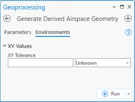

Eliminate small gaps
This tool now supports XY Tolerance environment values to prevent small gaps in geometry.

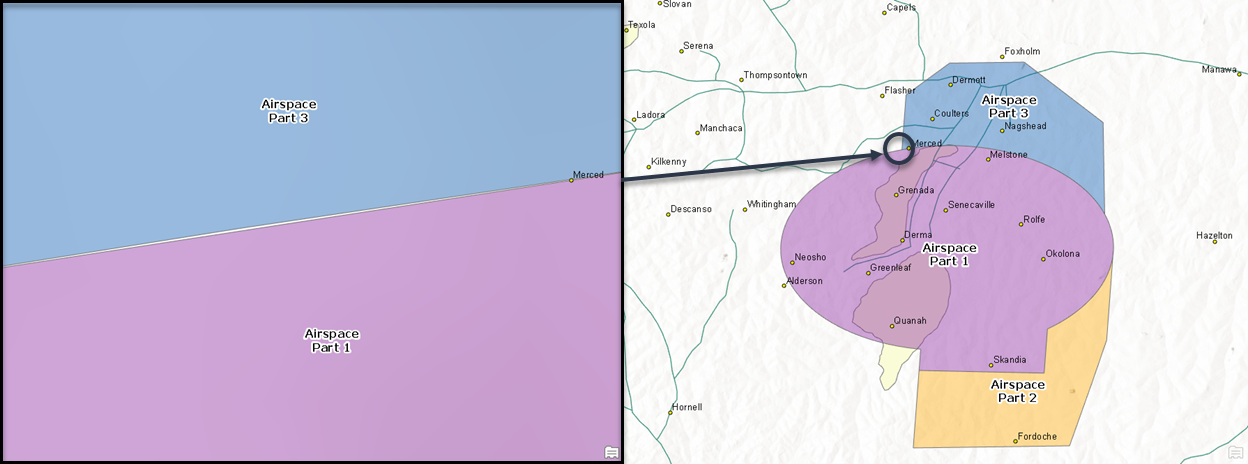

Small gaps between the geometry of the contributor airspace parts can lead to problems in the geometry in the resulting derived airspace.
The x,y tolerance can be used to account for these gaps between airspaces and allow the contributor shapes to be combined properly.
Derived airspace with XY Tolerance value apply results in a consistent border.
