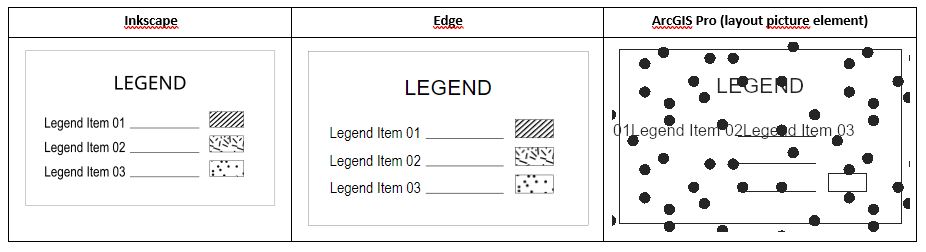

When loading svg file into layout of ArcGIS Pro project (as Picture element), there are several issues.
If the svg contains Pattern fill or the tag <tspan>, then it's corrupted, as can be seen on the attached image.
The svg shown on images above:

d="M 12.385677,0.83232784 23.360934,4.5482837"
id="path149744" />
<path
style="fill:none;stroke:#000000;stroke-width:1.75748;stroke-linecap:butt;stroke-linejoin:miter;stroke-dasharray:none;stroke-opacity:1"
d="m 26.980285,25.872 8.296895,3.778318"
id="path149746" />
<path
d="M 25.252966,16.540989 24.658408,13.466608"
id="path149748" />
</pattern>
</defs>
<g
id="layer1"
transform="translate(-34.227412,-86.337962)">
<rect
style="fill:none;stroke:#000000;stroke-width:0.0605329;stroke-dasharray:none;stroke-opacity:1"
id="rect146451"
width="74.100121"
height="45.866783"
x="43.869568"
y="98.455894" />
<text
xml:space="preserve"
style="font-size:5.64444px;line-height:1.25;font-family:sans-serif;-inkscape-font-specification:'sans-serif, Normal';text-align:center;text-anchor:middle;stroke-width:0.264583;font-weight:normal;font-style:normal;font-stretch:normal;font-variant:normal;font-variant-ligatures:normal;font-variant-caps:normal;font-variant-numeric:normal;font-variant-east-asian:normal"
x="80.876907"
y="109.95812"
id="text146507"><tspan
id="tspan146505"
x="80.876907"
y="109.95812"
style="font-size:5.64444007px;stroke-width:0.264583;-inkscape-font-specification:'sans-serif, Normal';font-family:sans-serif;font-weight:normal;font-style:normal;font-stretch:normal;font-variant:normal;font-variant-ligatures:normal;font-variant-caps:normal;font-variant-numeric:normal;font-variant-east-asian:normal">LEGEND</tspan></text>
<text
style="font-size:4.23333px;line-height:1.25;font-family:Arial;-inkscape-font-specification:'Arial, Condensed';text-align:center;text-anchor:middle;stroke-width:0.264583;font-weight:normal;font-style:normal;font-stretch:condensed;font-variant:normal;font-variant-ligatures:normal;font-variant-caps:normal;font-variant-numeric:normal;font-variant-east-asian:normal"
x="61.507942"
y="121.28548"
id="text146561"><tspan
id="tspan146559"
x="61.507942"
y="121.28548">Legend Item 01</tspan><tspan
id="tspan146607"
x="61.507942"
y="128.54297">Legend Item 02</tspan><tspan
id="tspan146609"
x="61.53688"
y="135.80046">Legend Item 03</tspan></text>
<path
style="fill:none;stroke:#000000;stroke-width:0.15;stroke-linecap:butt;stroke-linejoin:miter;stroke-dasharray:none;stroke-opacity:1"
d="M 74.908002,121.38929 H 95.515525"
id="path146674" />
<path
d="M 74.908,128.64678 H 95.515525"
id="path146676" />
<path
d="M 74.908,135.90427 H 95.515525"
id="path146678" />
<rect
style="fill:url(#pattern149559);fill-opacity:1;stroke:#000000;stroke-width:0.1;stroke-dasharray:none;stroke-opacity:1"
id="rect146680"
width="10.067796"
height="4.7906046"
x="98.632942"
y="131.03867" />
<rect
style="fill:url(#pattern149768);fill-opacity:1;stroke:#000000;stroke-width:0.1;stroke-dasharray:none;stroke-opacity:1"
id="rect146680-6"
width="10.067796"
height="4.7906046"
x="98.632942"
y="123.73118" />
<rect
style="fill:url(#pattern149774);fill-opacity:1;stroke:#000000;stroke-width:0.1;stroke-dasharray:none;stroke-opacity:1"
id="rect146680-4"
width="10.067796"
height="4.7906046"
x="98.632942"
y="116.42369" />
<rect
style="fill:none;fill-opacity:1;stroke:#000000;stroke-width:0.1;stroke-dasharray:none;stroke-opacity:1"
id="rect149776"
width="93.284431"
height="70.002647"
x="34.277412"
y="86.387962" />
</g>
</svg>
