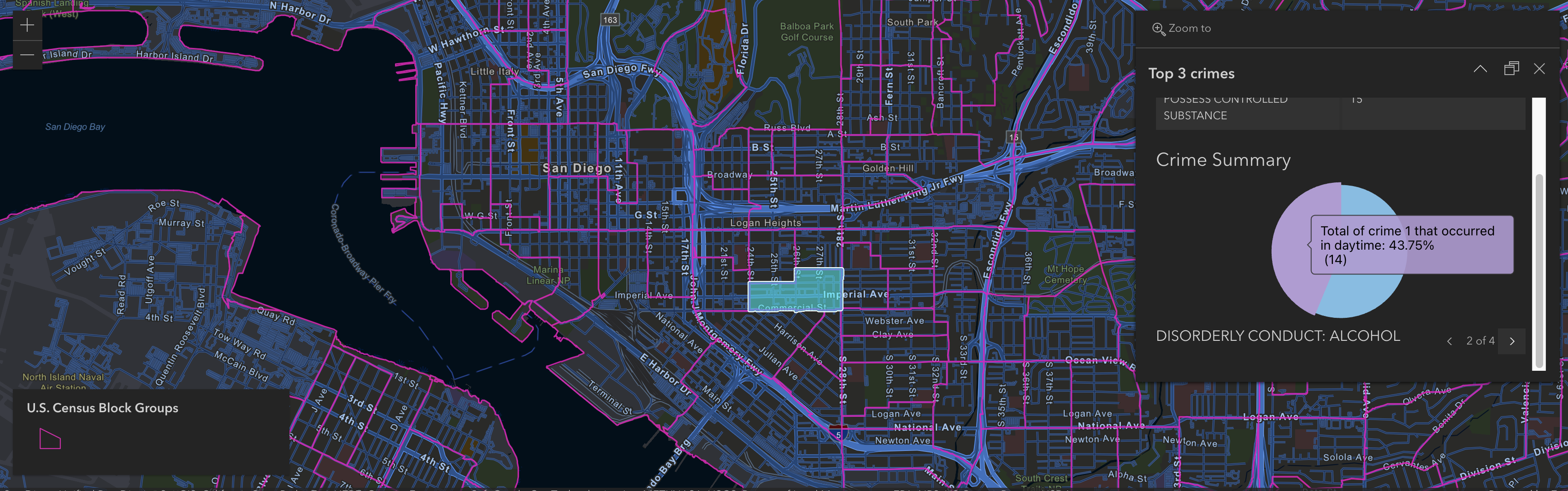

Arcade and pop-ups
You can use Arcade to format your pop-ups by calculating statistics from your layer, without having to make entirely new fields that are precisely formatted with this pre-calculated data.
