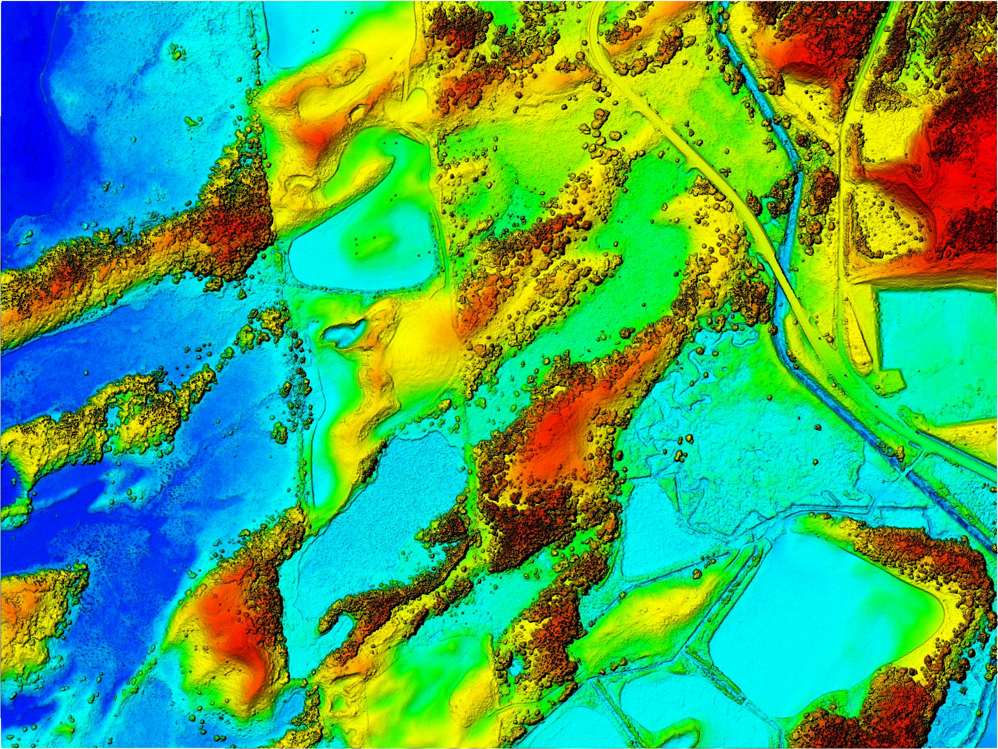

I created a ShadedRelief map using the EQAREA option of the Arc/Info Grid Slice tool and AML:

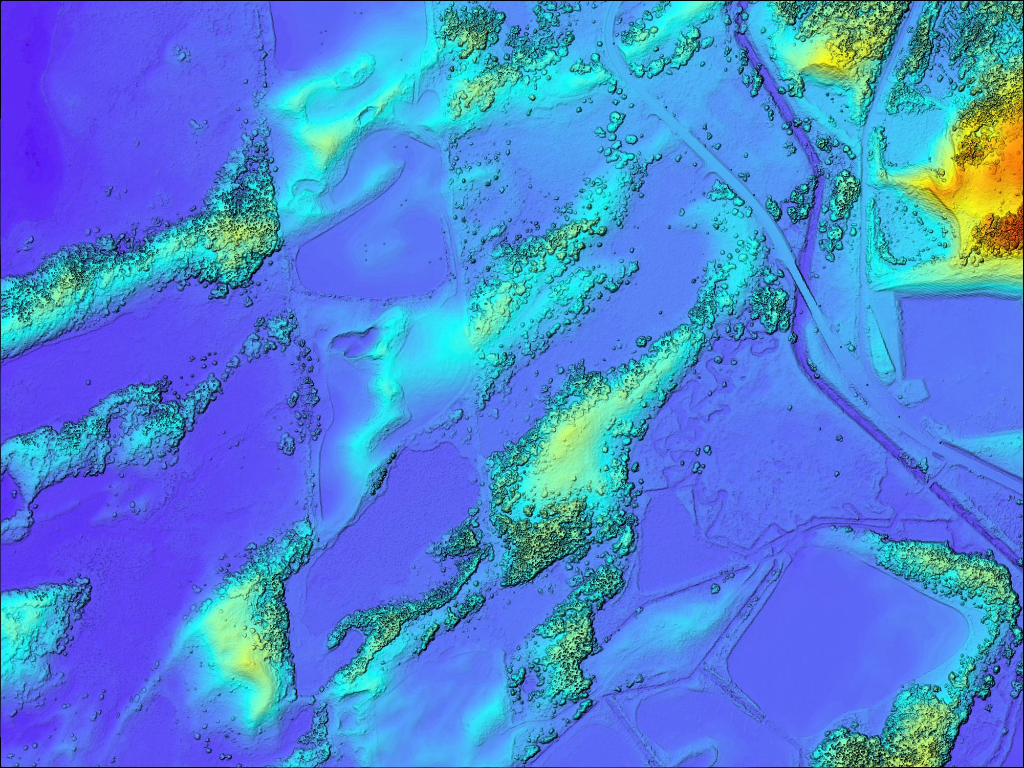

I created a shaded relief map using the arcpy.ia.ShadedRelief function in ArcGIS Pro:
color_ramp = 'Spectrum By Wavelength-Full Bright'
relief = arcpy.ia.ShadedRelief(dem_raster,315,75,1,color_ramp,'Degree')
The {slice_type} option is not availble for both arcpy.sa.ShadedRelief and arcpy.ia.ShadedRelief tools.
