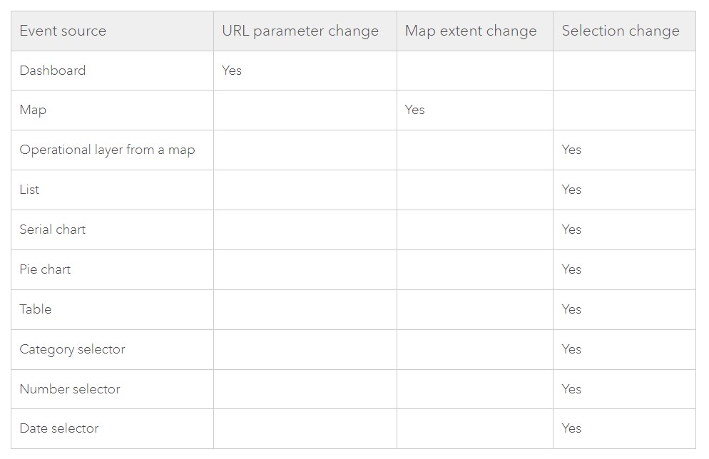

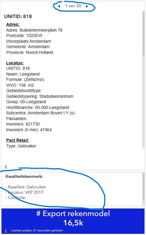

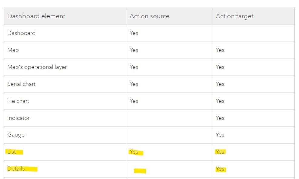

In an operation dashboard the 'detail widget' is often used as an overview window for the selected objects. In most cases you have more objects that you 'swith' through in the widget.
Most of the widgets are interactive with other widget, only the select 'next' object in the detail list has no action trigger to other widgets.
In example you have a detail widget and a list widget. The second widget you want to use for displaying a foto or attachment. If you select an area in the dashboard the amount of objects changes in the list, just like other connected widgets. If you select the next object in the detail widget the photo of the other widget, won't change (no action triggered).
