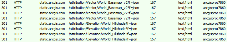

I installed Fiddler and monitored the traffic, finding that every time this window pops up these HTTP responses show up using a 301 code stating "301 Moved Permanently". I suspected this was potentially caused from our basemaps were not the most recent vector basemaps. So I double checked what is available in AGOL right now to what is used in our Portal. They are exactly the same. It only seems to be triggered when the Service Layer Credits are accessed whether that is from the button in the map view or from a layout with a Service Layer Credits Dynamic Text Box.
