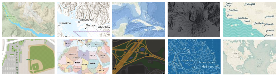

The Basemap styles service v2 (beta) (aka v2 (beta) services) provides dozens of ready to use styles such as: streets and navigation; topography and imagery; reference; and creative. The service also contains a number of brand new styles, such as ArcGIS Outdoor and OSM Navigation, that you can't access using the existing Native SDKs - and you can even select the language to use for localized place labels. Like the existing v1 service, the v2 (beta) services can also access custom styles stored in ArcGIS.

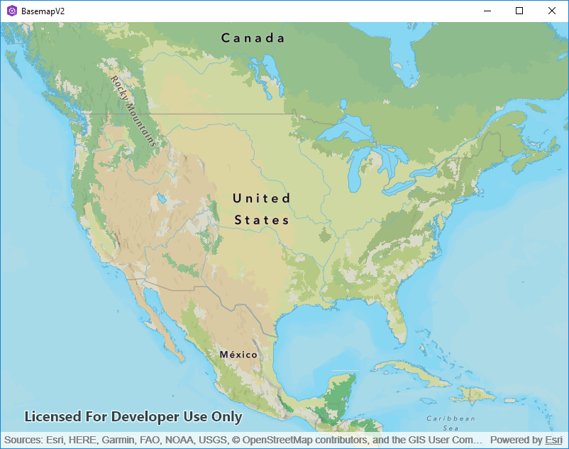

When you run your app you will see the beautiful new ArcGIS Outdoor style basemap displayed.
