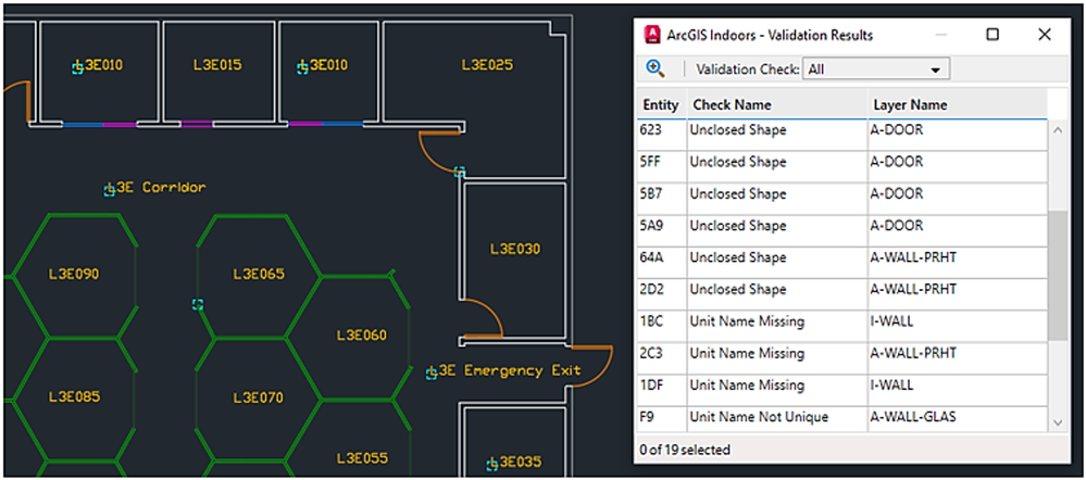

To help with this, an ArcGIS Indoors plug-in has been developed for AutoCAD that can diagnose CAD floor plan readiness by checking for missing data or incorrect geometries before importing into the Indoors geodatabase. At time of publishing, the plug-in can check for the following conditions:
- Unclosed room boundaries, where small gaps with dangling endpoints may prevent Units from importing as expected. For example, here’s a door swing arc (brown) that stops several millimeters away from connecting with a wall (gray).
- Self-intersecting polylines that loop back on themselves and may unexpectedly import as multi-part features.
- Missing or conflicting room names, which can lead to unexpected results when searching or wayfinding with an Indoors app.
The plug-in marks these conditions on the drawing and lists each occurrence in an interactive table. The marks (cyan by default) and the table make it easy to quickly locate and review each occurrence, allowing the AutoCAD user to focus on fixing—rather than finding!—potential issues.
