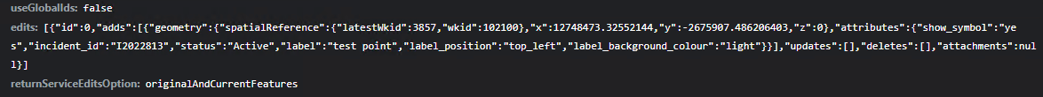

Looking at the body of the request:
and the documentation of applyEdits, the originalAndCurrentFeatures option is only valid when rollBackOnFailure is true. As rollBackOnFailure isn't being set in the request, I'm guessing it's defaulting to false, which is causing my error.
Is there a way I can get the Editor Widget to send the rollBackOnFailure parameter as true without customizing?
