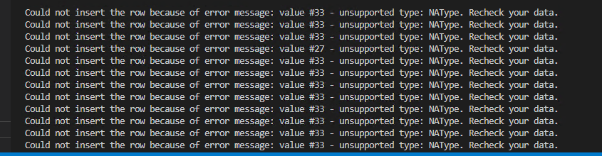

Currently when a Spatially Enabled Dataframe contains the NA Type, to process to_featureclass() fails less than gracefully.
- The error message returned does not provide context for the row number and field that contain the error

- The minimal solution would be better error message output to provide a user explicit instruction on both row number (object_id since this is coming out of a spatially enabled dataframe) and column name/index.
