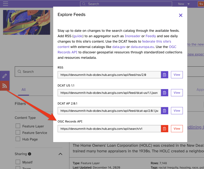

Like other Hub feeds, RSS 2.0 is site-level API endpoint for accessing a Hub site’s catalog. Open the Hub feeds modal and select “View” to see the raw XML response.
Above is a screenshot of the Hub feds modal. You can see all of the Hub feeds including RSS and the newest feed highlighted in red – OCG API – Records.

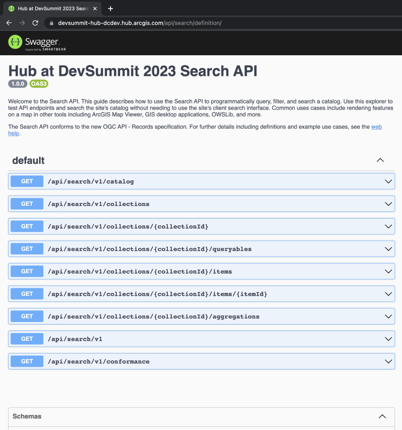

Furthermore, you can supply a token and query private content if a site catalog contains private content. You can also build compound filters to find the exact data you’re looking for. We recommend testing out the OpenAPI sandbox to see different query parameters and API endpoints.
Above is a screenshot of the OpenAPI sandbox for the Hub site demonstrated during Esri’s 2023 Dev Summit

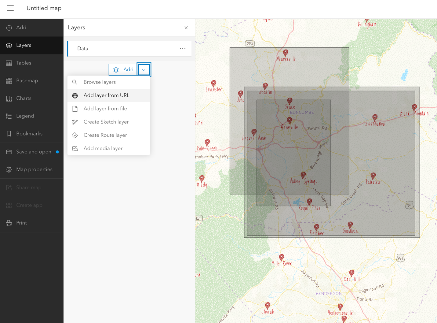

Once ready, navigate to your favorite Hub site again, open the Hub feeds modal, copy the OGC Records URL and follow these docs to bring your content into ArcGIS Pro or ArcGIS Online. For example, you can add a Hub site’s collections such as “datasets” to a web map by selecting “Add layer from URL”, supply the search API root (ex `<aHubSiteURL>/api/search/v1`), and then select “OGC feature layer”.
Above is a screenshot of an ArcGIS Online web map with a layer added from the “Data” collection of a Hub site about Asheville, NC, USA. To add data using Hub site’s OGC API – Records API, select the dropdown next to “Add”, and select “Add layer from URL”.
