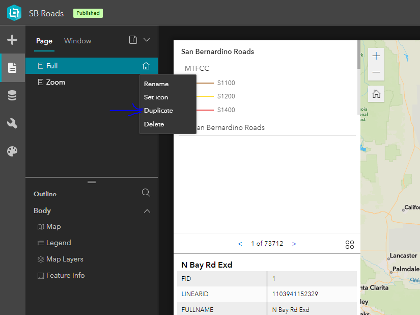

The first trick – is to use the ‘page’ functionality that is found in Experience Builder. After I have my application built out, I just duplicated it under the pages section.

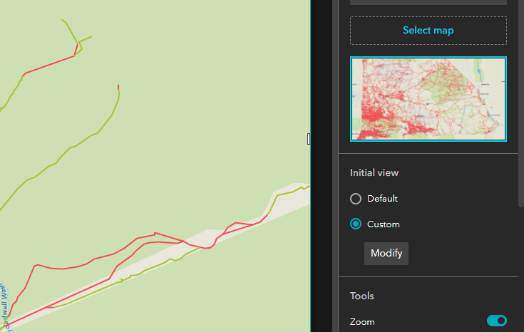

You can then rename your pages, which will be used in the URL. After you have your second page created, go to the settings for the map object and modify the initial view of the map. It doesn’t matter where you focus on, just what zoom scale you use.

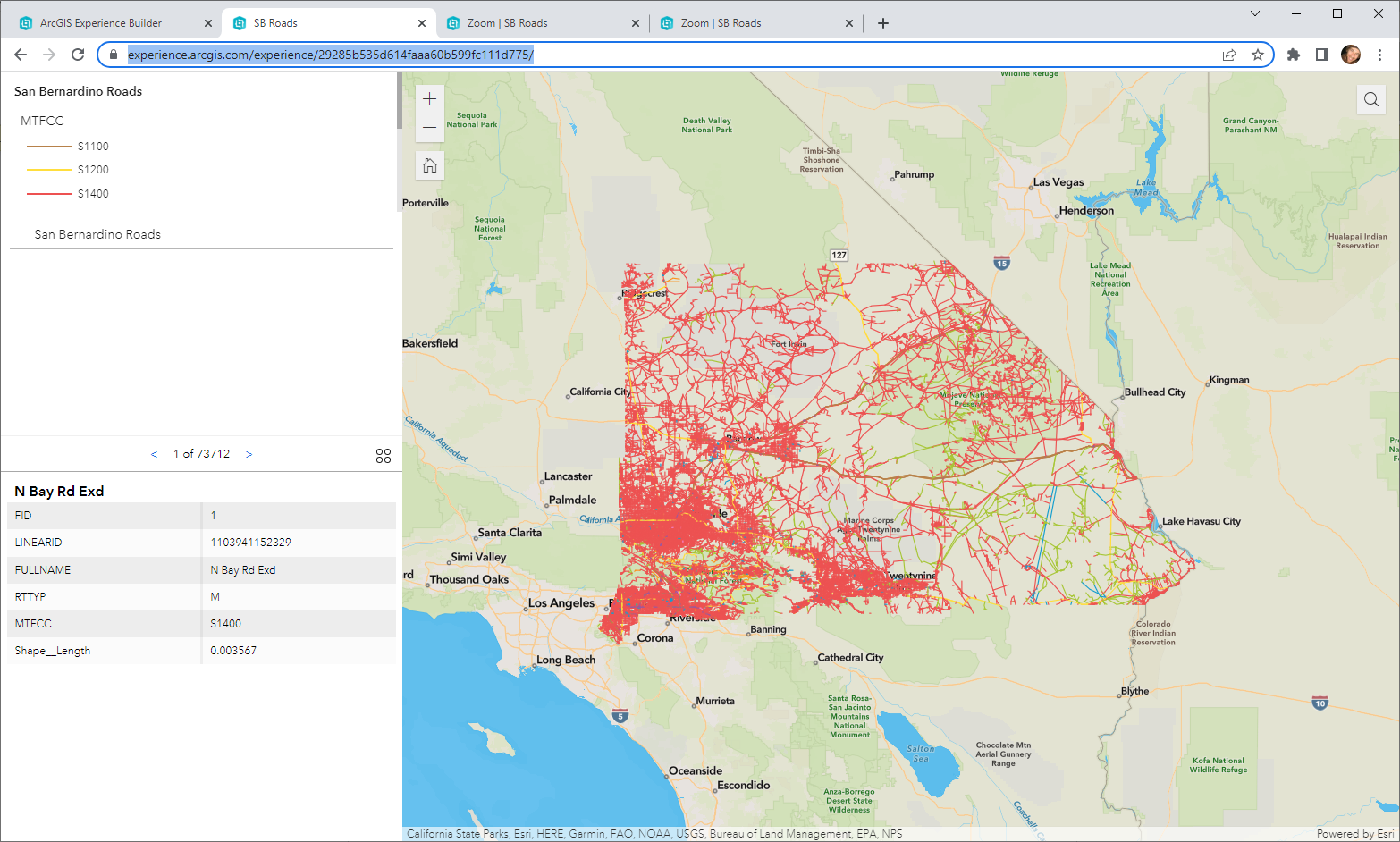

The first URL parameter is simply the ‘page’ parameter – my original/normal app can use the default URL, or the URL to the specific page as shown here:
https://experience.arcgis.com/experience/29285b535d614faaa60b599fc111d775/page/Full

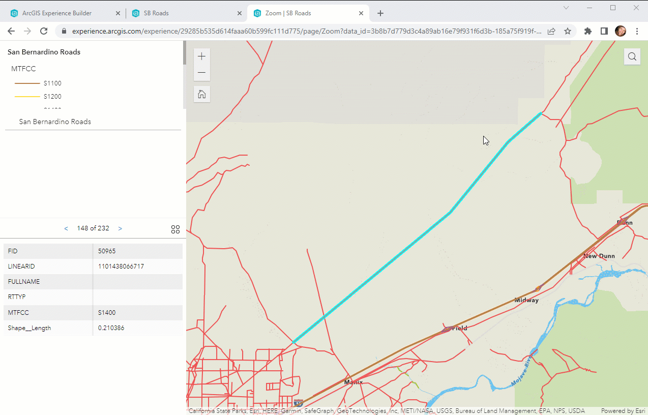

But if I want to drive users to a specific feature at the zoom scale I pre-defined, I need to use the other page that I created along with the details of the specific feature. For my app, the data, and my feature, that would look something like this:
https://experience.arcgis.com/experience/29285b535d614faaa60b599fc111d775/page/Zoom?data_id=3b8b7d779d3c4a89ab16e79f931f6d3b-185a75f919f-layer-86%3A50965
If I want to change the feature that gets selected in the map, I can modify it manually, or you could do this programmatically as well. If you want to play with it manually, just modify the last characters in the URL following the ‘A’ character. This is the ObjectID for the feature.
For example, take the URL: https://experience.arcgis.com/experience/29285b535d614faaa60b599fc111d775/page/Zoom?data_id=3b8b7d779d3c4a89ab16e79f931f6d3b-185a75f919f-layer-86%3A50965
Then replace ‘50965’ at the end of the URL string with ‘50089’, ‘32219’, or try any number!
