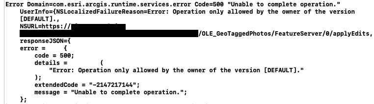

This error is logged in Server Manager after attempting a data-modifying operation: "Operation only allowed by the owner of the version [DEFAULT]" Here is the error output in the console of the client app:

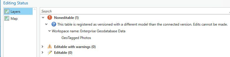

This is what I see when I select the layer, then go to Edit > Status.
I suspect this has something to do with the branch versioning being enabled. Is there something I do in ArcGIS Pro to modify the layer so clients can edit the data? Let me know what other info would be helpful to solving this.
