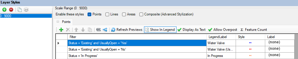

- ArcGIS Pro or any other ArcGIS products doesn't have much flexibility in having symbology based on multiple values of different fields. Please see the following MapGuide web layer symbology example...
I couldn't belive an enterprise GIS can't do something like this, but an Open Sourve web GIS can do this type of symbology so easily.
