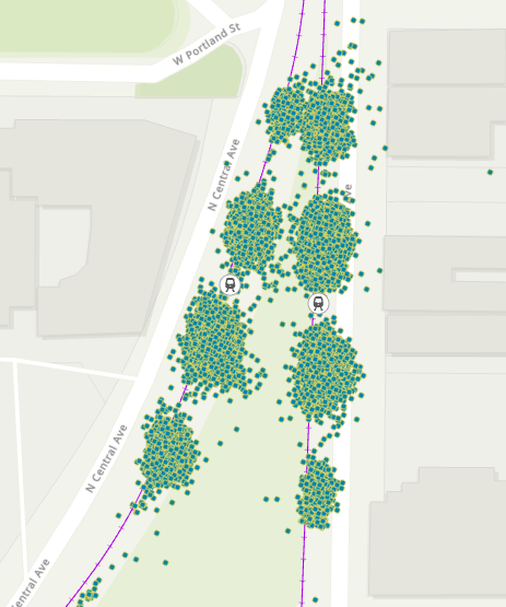

We have light rail ridership points that get generated when the cars stop at a station and people either get off (alight) or get on (board). This is supposed to occur next to a station, but due to irregularities in GPS locating they sometimes occur at a distance away from the station. In order to identify which station the records belong to, I developed a SQL Server procedure that (using SQL Server Spatial tools) determines the nearest station based on distance.
This works pretty well until you get to some stations that are really close,
or where the Eastbound/Westbound lines actually share the same station.

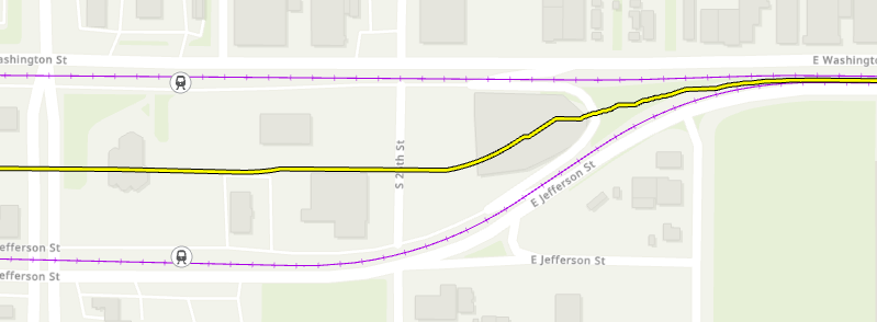

Not sure how to use this command I kept looking and came across the CollapseDualLinesToCenterline command for ArcMap. Not finding an equivalent for Pro, I fired up the ArcMap I still have on my desktop and within a minute I had the centerline I was looking for:
Not sure why it does some of the squiggles it does, as the existing routes don't seem to deviate that much, but at least it's a start in getting something to work with. Now I can get on with creating polygons around each station.
