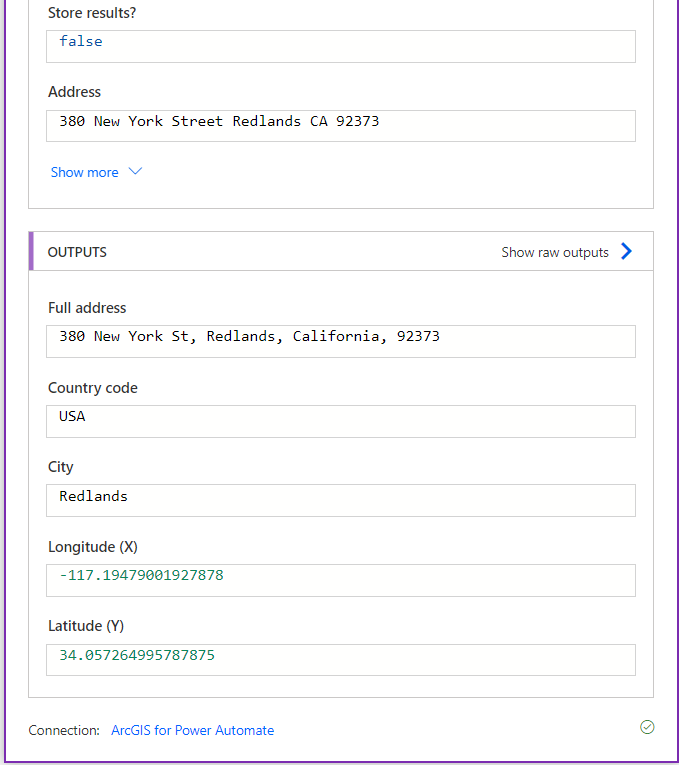

Geocoding (not stored)
A bug was identified in the ArcGIS for Power Automate connector when using an API key and geocoding locations in a flow. If the option "no" was chosen under "Store Results", the lookup process would fail and then the flow would ultimately fail.
This issue has been resolved and you can now choose any option and receive the appropriate results. This is an important fix because you might have your API key configured to not store results when geocoding.
