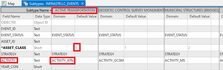

For a table that has a subtype:
The subtype fields have domains.
For example, when the ASSET_CLASS subtype value = 0 (ACTIVE_TRANSPORTATION), the ACTIVITY field uses the ACTIVITY_ATN domain.
Problem:
Just like with regular domains, subtype domains can be easily overridden via the Field Calculator and other mechanisms.
For example, 'asdf' is not a valid ACTIVITY_ATN domain code, but I can still enter that value via the Field Calculator.
