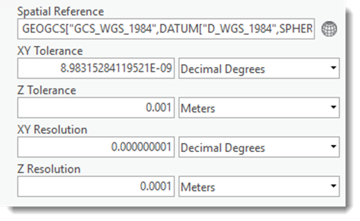

Following example shows the default settings using USA Contiguous Albers Equal Area Conic WKID 102003. Note that using Geographic Coordinate System WGS 1984 WKID 4326 will default the XY Tolerance and Resolution to Decimal Degrees.
USA Albers GCS WGS 1984

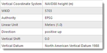

Resulting Spatial Reference settings at the LRS dataset including Projected Coordinate System (PCS), Geographic Coordinate System (GCS) and Vertical Coordinate System (VCS):

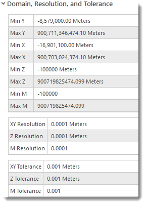

Resulting Tolerance and Resolution settings (in Meters per the parameters) at the LRS dataset:

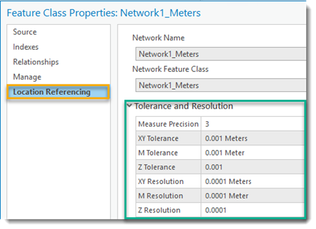

Once the LRS is created, the Create LRS Network tool offers option to set the Units of Measure along the Network. The Units can be user defined and changed per requirements (supported units include Kilometers, Meters, Centimeters, Miles, Yards, Feet or Inches). Following example shows the default units of Meters using USA Contiguous Albers Equal Area Conic WKID 102003.

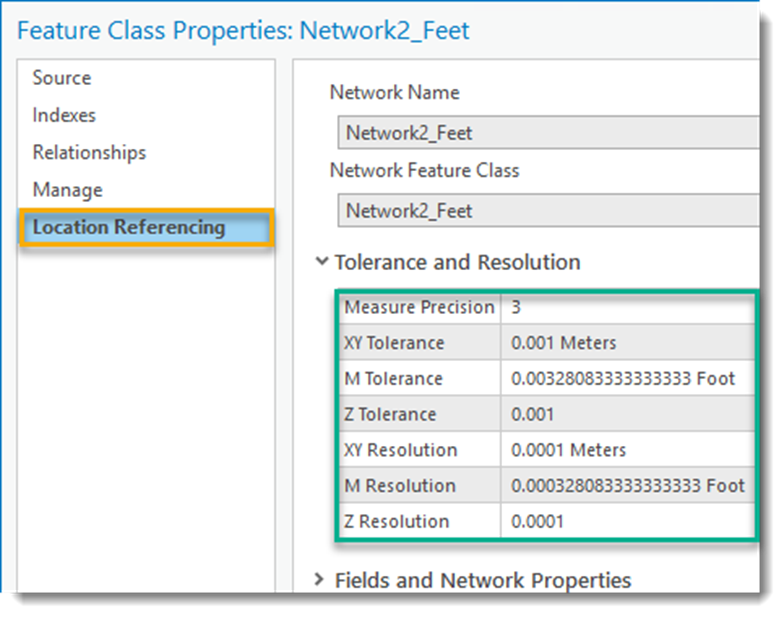

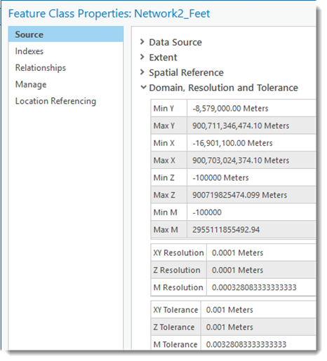

Following example shows creating a second network and defining the units to Feet using the LRS that is using USA Contiguous Albers Equal Area Conic Meters.
APR calculates the required M tolerance and resolution for the network feature class that will align the XY tolerance with that of the M tolerance in the desired unit of measure. The XY and Z tolerance and resolution for the network will come from the centerline of the LRS.
As in the example above, the XY tolerance is 0.001 meters and the M tolerance is set as 0.00328083333333333 for the LRS Network measured in Feet. The XY resolution is 0.0001 meters and the M resolution is set as 0.000328083333333333 for the LRS Network measured in Feet. ArcGIS stores the measure values on each vertex of the polyline M-enabled feature class. This is the geometry model that ArcGIS and APR is based on.

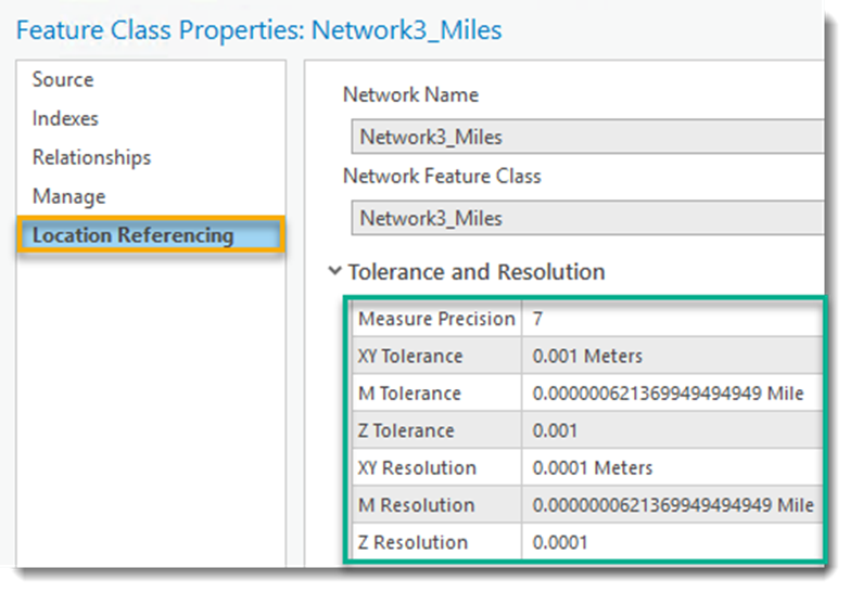

Following instance shows creating a third network and defining the units to Miles using the LRS that is using USA Contiguous Albers Equal Area Conic Meters.

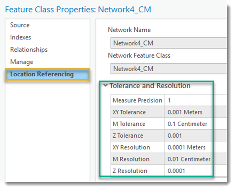

Following example shows creating a fourth network and defining the units to Centimeters using the LRS that is using USA Contiguous Albers Equal Area Conic Meters.
