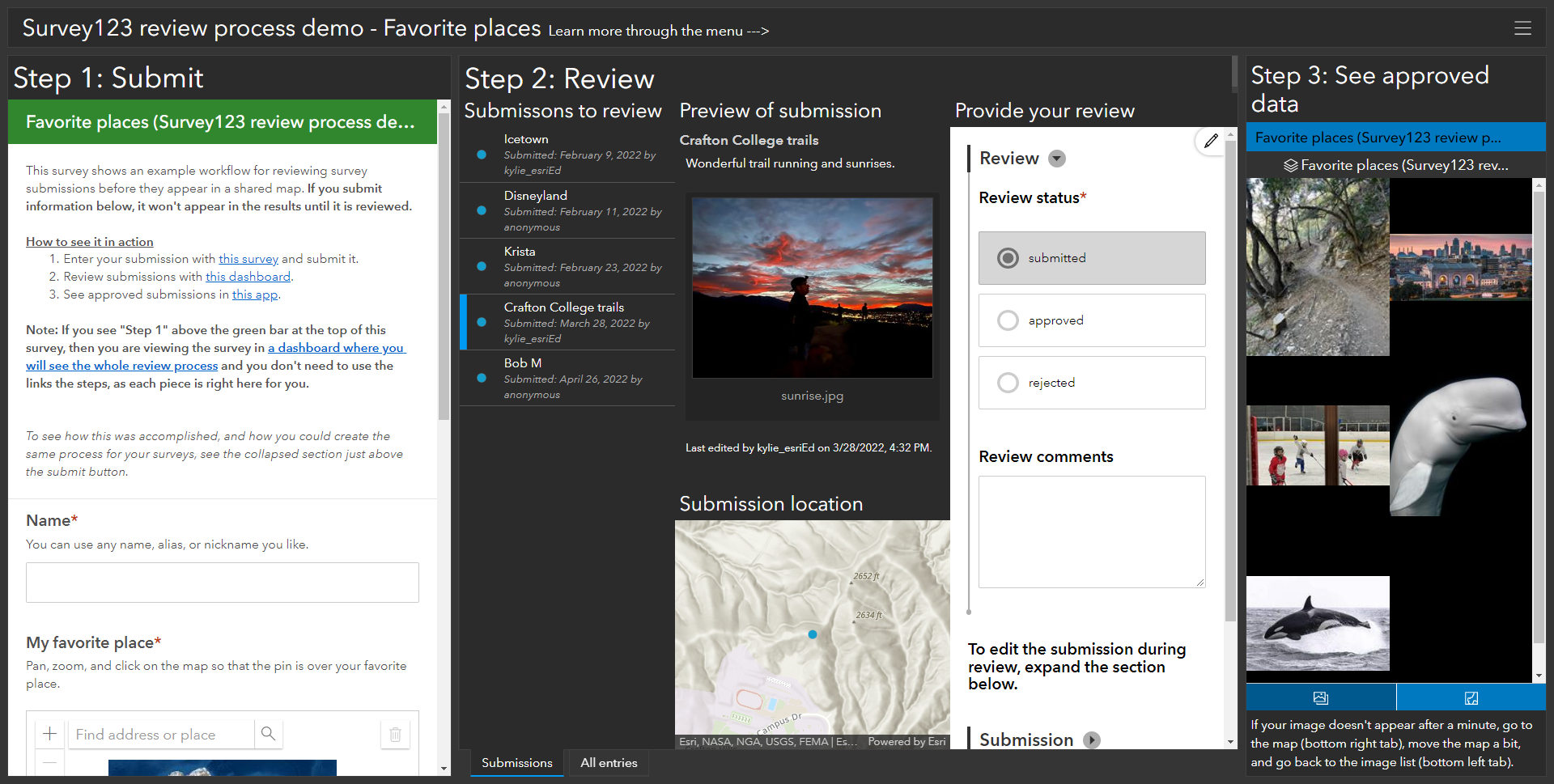

So how can we create a survey with a review process in place? Here are the highlights:
- Create a survey just like you usually do.
- Add a field to the data that stores if it is reviewed or not.
- After entries are submitted, review each submission and mark it as approved or rejected.
There are a number of ways to review the data, but I find using a dashboard is a pretty slick way to do so, especially when you have a high volume of data and want to have a list of just what is left to review. - Create a layer view that only includes the approved data, and use it in maps and apps for your class to see.
Want to try it out for yourself? Head over to this dashboard to see how it works once all set up: you'll submit the survey, review your entry, then see it in the approved results.
Are you ready to see the full implementation details? Head back to the dashboard and expand the section at the bottom of the survey. Questions? Just leave a comment here.
These are wrapped into a single dashboard to give you one place to see the workflow. In reality, your survey will be handed out as it always is, the dashboard will just be for your use, and you'll use the approved results the same way you use results today.
