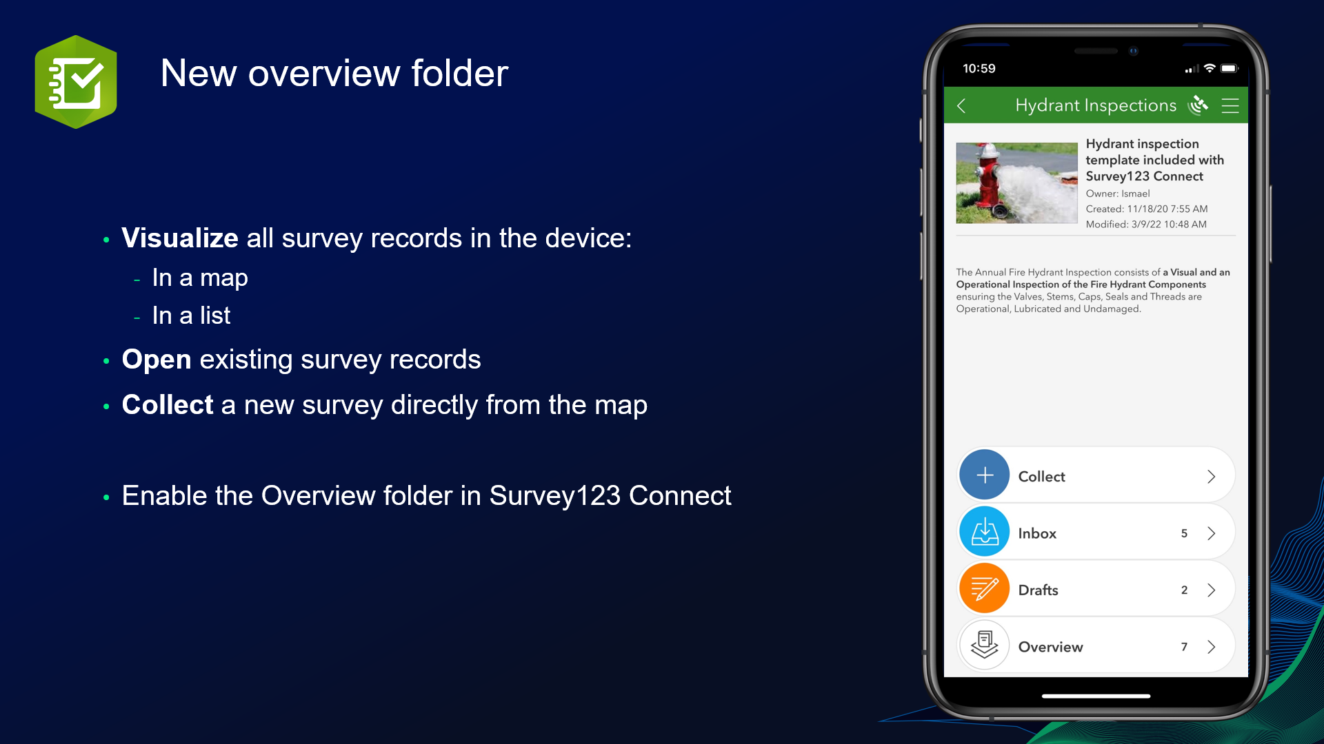

How is the Overview folder different from the Sent folder? The Overview folder is designed to help end users visualize all survey records in the device. That is, records from the Drafts, Outbox, Inbox and Sent folders. Records are displayed as a list, and in a map. Additionally, you can also use the Overview to create a new survey at a particular location using a map.
The Sent folder helps end users understand what records they have already sent to ArcGIS. The author of the survey can allow end users to open and edit already sent records.
Does the Overview work offline? Yes.
How do I enable the Overview? In Survey123 Connect, open your survey and go to the Options tab. You will find an option to enable/disable the Overview.

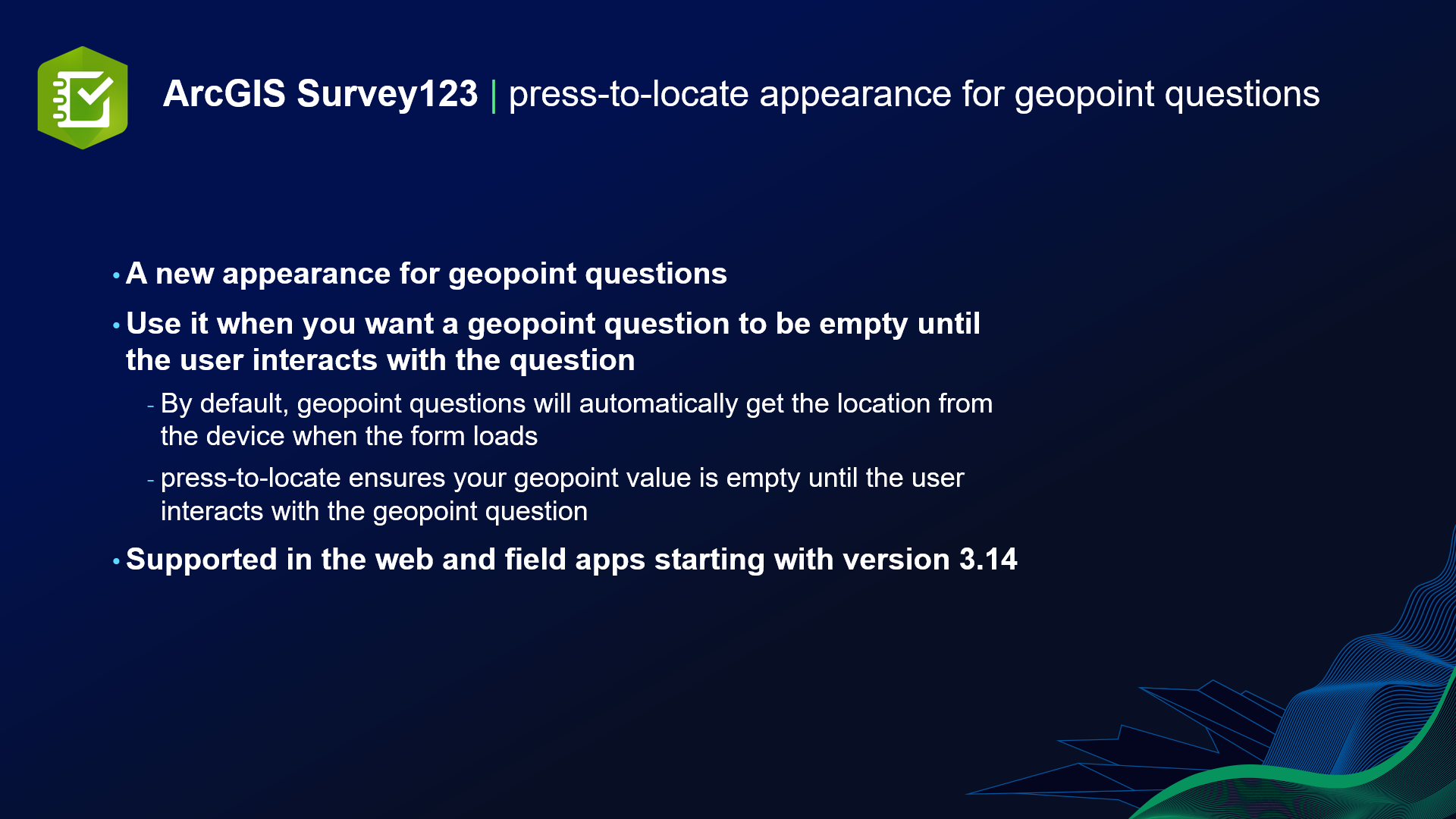

What is the reason why you added support for press-to-locate? The default behavior of geopoint questions makes Survey123 set the value of the geopoint when the form load using the current user location. This works in many scenarios, but not always. For example, say a Survey123 user opens the form in the office and leaves the form open. Once in the field, the user brings up Survey123 again and starts completing the form. Since the form was initialized in the office, the geopoint question is already set to the location of the office, which is incorrect.
The press-to-locate appearance allows you to leave the map question without a value. Only when the user interacts with the question, the location of the user is collected. In most cases, you want to combine the press-to-locate appearance with a required geopoint question.

- Use the location of the user when the form loads to center the map and set its value:
- In the survey worksheet, add a geopoint question leaving the default column empty
- Leave the map question without a value until the user touches the question. At that point, get the user's location to center the map and set its value:
- Add a geopoint question and set its appearance to press-to-locate

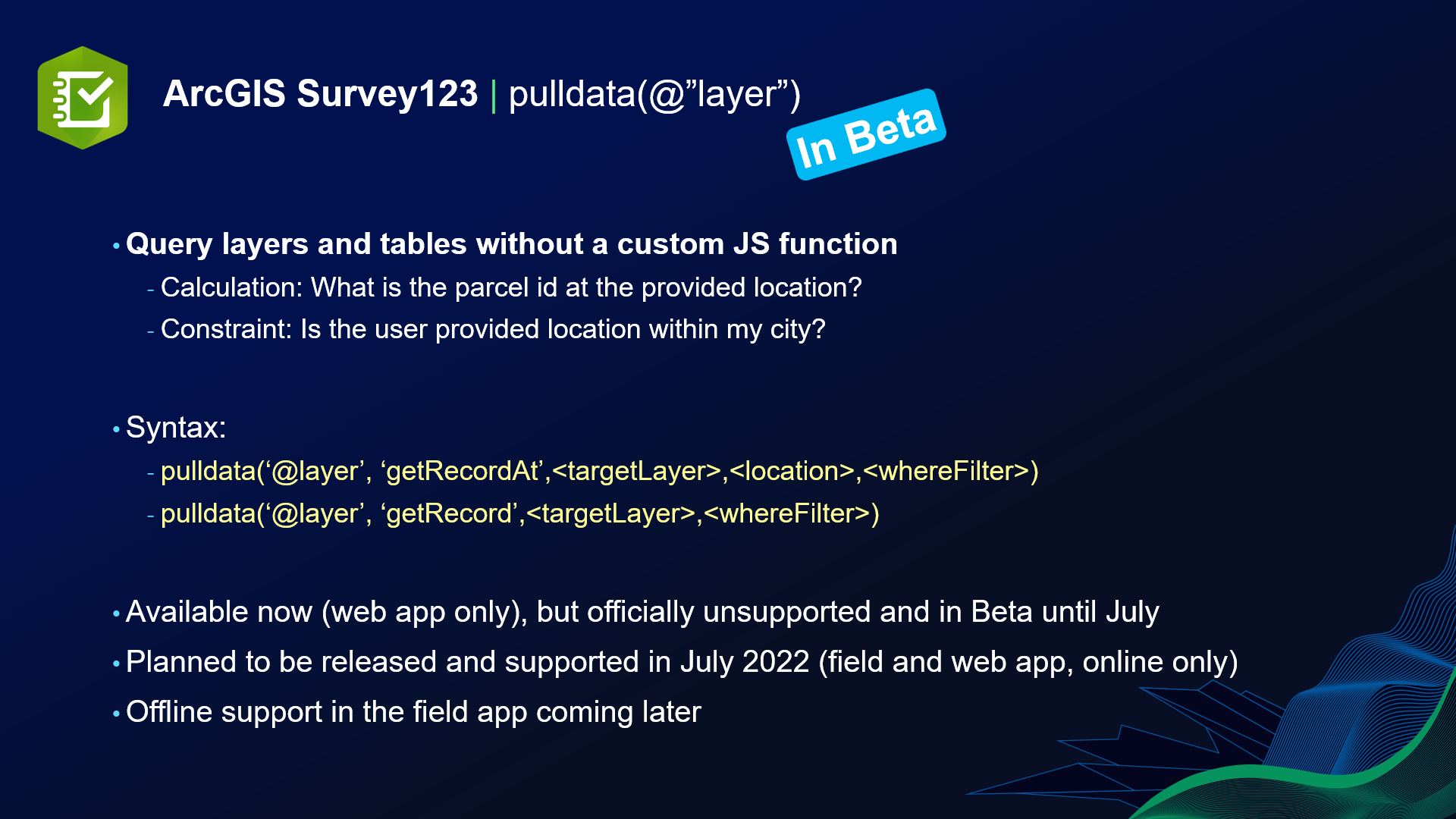

Can I use pulldata("@layer") without an ArcGIS account? Yes, pulldata("@layer") can be used in public surveys. Respondents are not required to login for this function to work.
Why pulldata("@layer") does not work in Connect? pulldata("@layer") is currently in Beta and not fully implemented. As of today, it only works in the Survey123 web application. You will need to include your pulldata("@layer") expressions in your XLSForm, publish and test in the web app. Support in Connect and the Field app is planned for July 2022.
