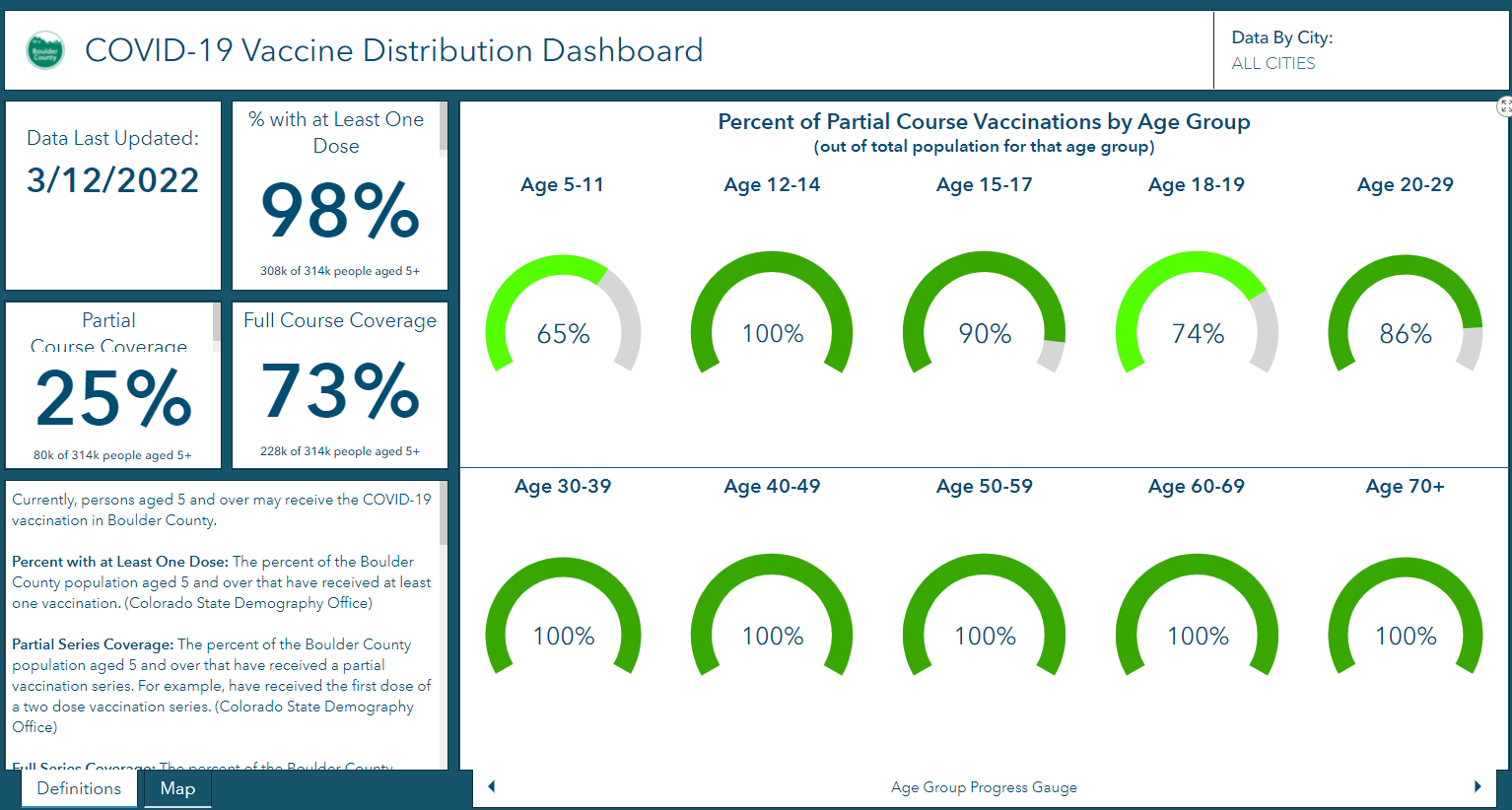

In the Boulder County Vaccination Dashboard 40 gauges rely on one table, and 5 serial charts and 3 other elements rely on another table. But all that is multiplied by 4 since there are four versions of the dashboard (Desktop, Mobile, Spanish, Desktop Test). So there are actually 32 charts/elements that rely on one table and 160 gauges that rely on another table. Here is a screenshot showing just a few of the gauges (there are many more gauges and serial charts in the dashboard)
