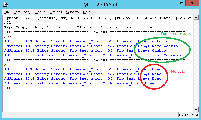

I ran into a strange problem with the arcpy.CalculateField_management tool. I'm not sure if this is a bug or just an error in my thinking, but I thought I'd post it just in case someone else has the same issue.
If you run the commands in this order they work fine.
- arcpy.MakeTableView_management(mainTable, "tableView")
- arcpy.AddField_management(mainTable, "Province_Long", "TEXT", 100)
- arcpy.AddJoin_management("tableView", "Province_Short", lookupTable, "Prov_Short")
- arcpy.CalculateField_management("tableView","MainTable.Province_Long","!LookupTable.Prov_Long!","PYTHON")
- Result are as expected (the Province_Long field has data in it)
If you run the commands in this order they do not work.
- Result are not as expected (the Province_Long field has no data in it)
No error is thrown, meaning that the field Province_Long exists and can be found, but for some reason the data is not being retrieved from the joined table. This only occurs when you are calculated from a field from the joined table.
I also built a stand-alone script if someone wants to replicate the issue on their end. To change the script from not working to working, swap the two lines of code under #Swap these two lines
