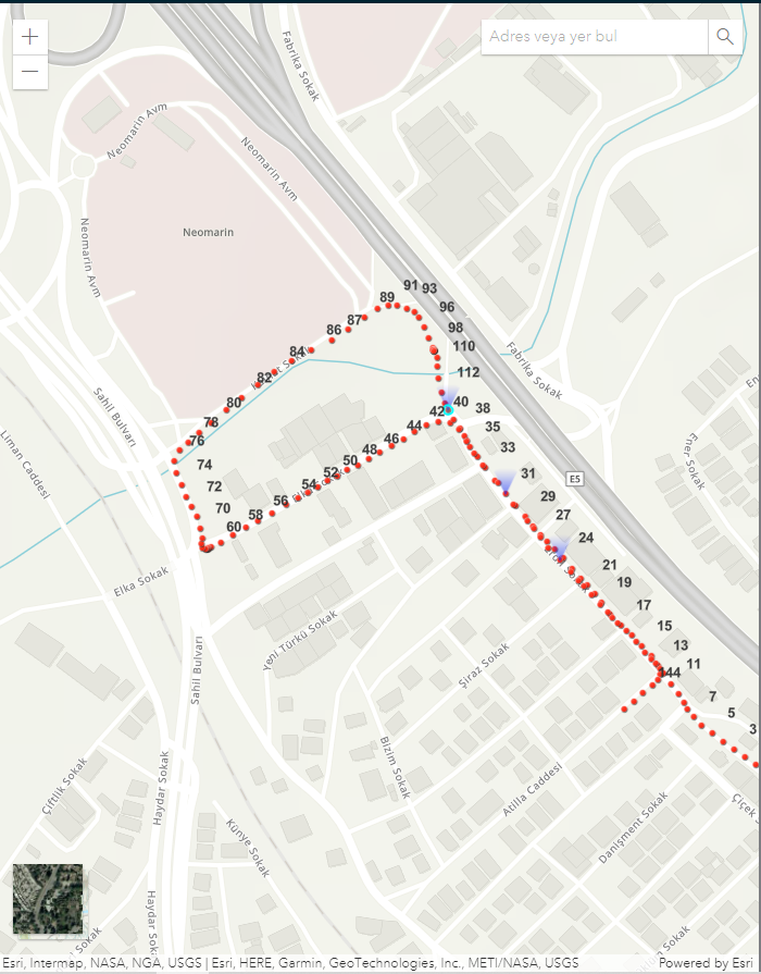

Second Question;
When I add a new marker there are multiple markers as in the picture, I want the previous marker to be deleted but the clear() method is not working.
if(pointGraphic){
pointGraphic.clear();
How can I do this?
