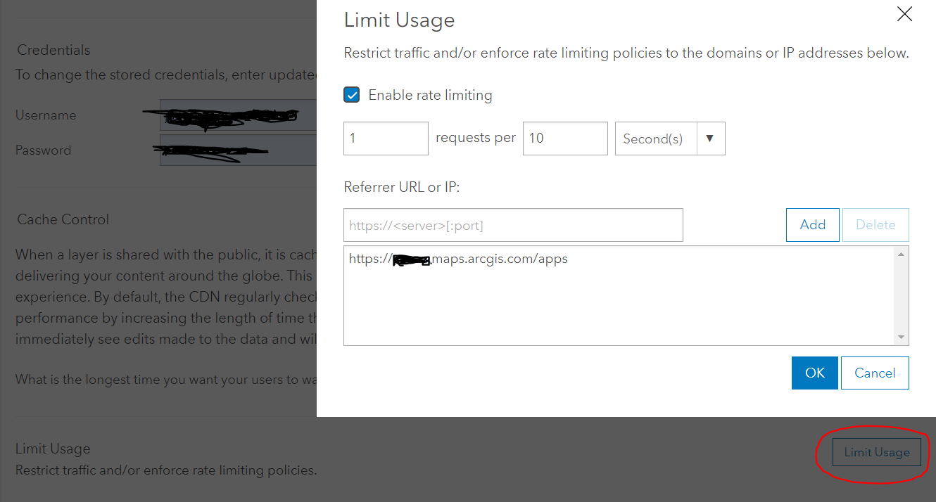

Manually in ArcGIS Online (AGOL) now, one can create a secure service of an existing hosted feature layer by storing their credentials (ArcGIS Online username and password) within the new service itself (see here). After this, one can then alter the settings of the new secure service to Limit Usage of the service by enabling a timed rate limit and specifying very specific IP or URL addresses where the service can appear. Following the documentation in the following links will lead you to this look on a browser:
