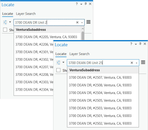

Here is what I expect the results to be where in this example they actually use a keyword Unit, but I don't believe that is even necessary. Using type ahead, 3700 Dean Dr. should return all the choices.
