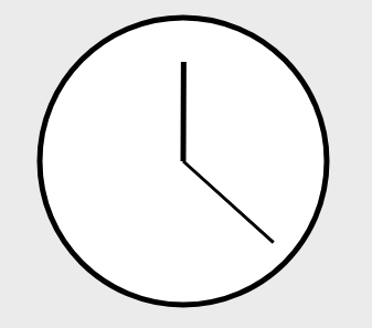

Without any attribute rotation, this HTML would look like this:
Which Widget?
Our single requirement is that we be able to access the HTML source editing and be able to pipe in attributes, which pretty much just leaves us with the List widget. Nothing else gives us both.
As silly as a single-item list is, we'll do it. Create a list, reference the data expression, and go to the Line Item Template editor and switch it to Source, then paste in the HTML above.
That's it! Your clock should now be referencing the calculated attributes and reflecting the current time. I changed my widget background to make it easier to see.
