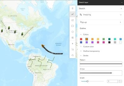

Basic Sketching Workflow
You can use the same basic workflow to sketch on any map.
- Click Add sketch on the light toolbar. A sketch layer is added to the map and the Sketch pane and sketch tools appear on the map.
NOTE: If you see Sketch instead of Add sketch, a sketch layer is already set up and you can click Sketch to start sketching.
- Click the sketch tool you want to draw with. Maybe you want to stamp on the map (with a point). Or perhaps a line, polygon, or text will better suit what you are sketching.
- Configuring the look of your sketch in the Sketch pane. Depending on the tool you are using, you'll be able to change the symbol, fill and outline colors, rotation, size, stroke pattern and width, transparency, font, text content, and text halos.
- In the Sketch pane you can also configure if clicking the sketch on the map shows a pop-up, and if so, the contents of the pop-up.
- Click the map to draw your sketch.
