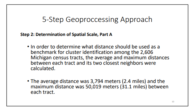

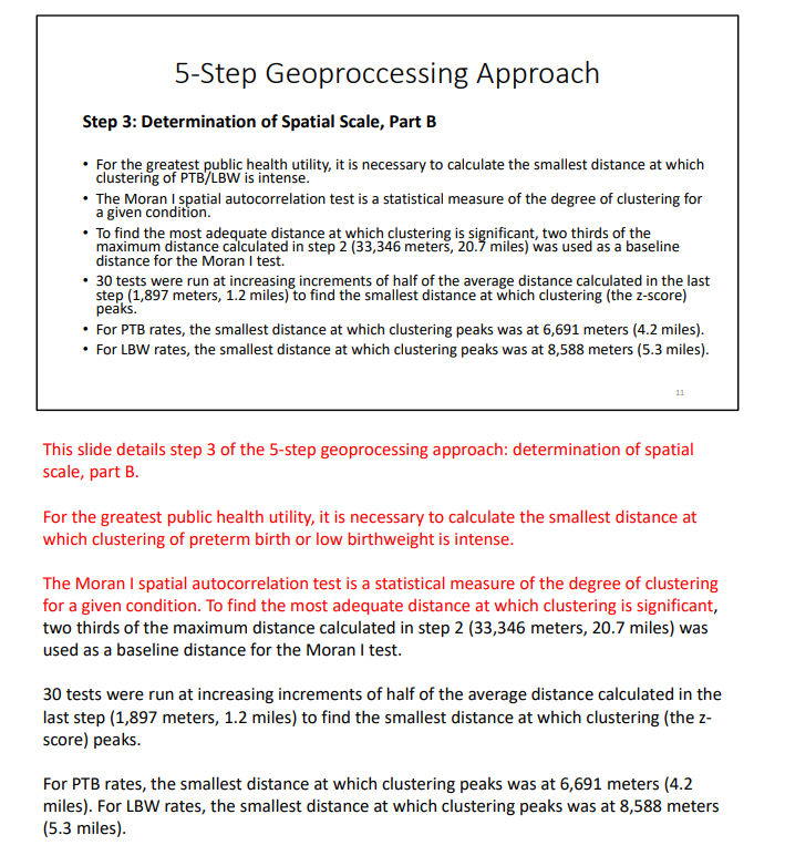

This slide from page 11 that talks about Step 3 of the geoprocessing approach (I am going to include the step 2 slide from page 10 as well for context, see below).
I do not understand how they ended up finding distances at which clustering peaks of 4.2 miles and 5.3 miles for their two rates (see the last two lines of the second slide) if the Beginning Distance for the Incremental Spatial Autocorrelation was set to 20.7 miles? Surely that means that the distances at which clustering peaks will have to be higher than 20.7 miles since in Incremental Spatial Autocorrelation you increment up from the Beginning Distance, not down? What am I missing here?
