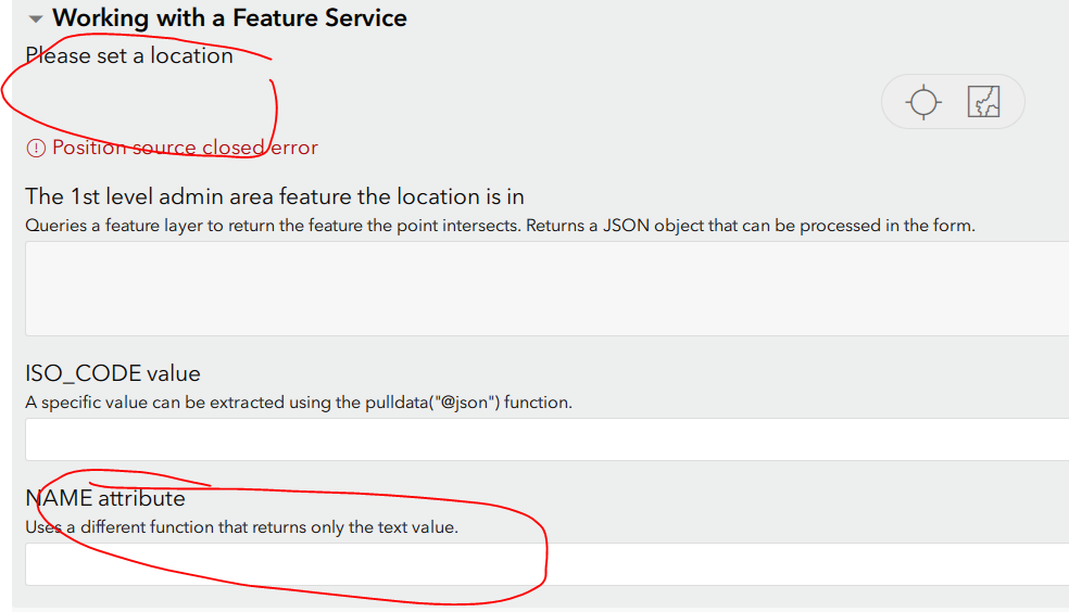

Here is the form for reference as you see it in the example.
Here is the excel that comes with it as well.
