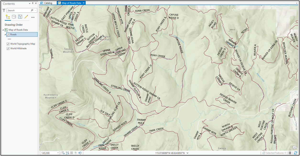

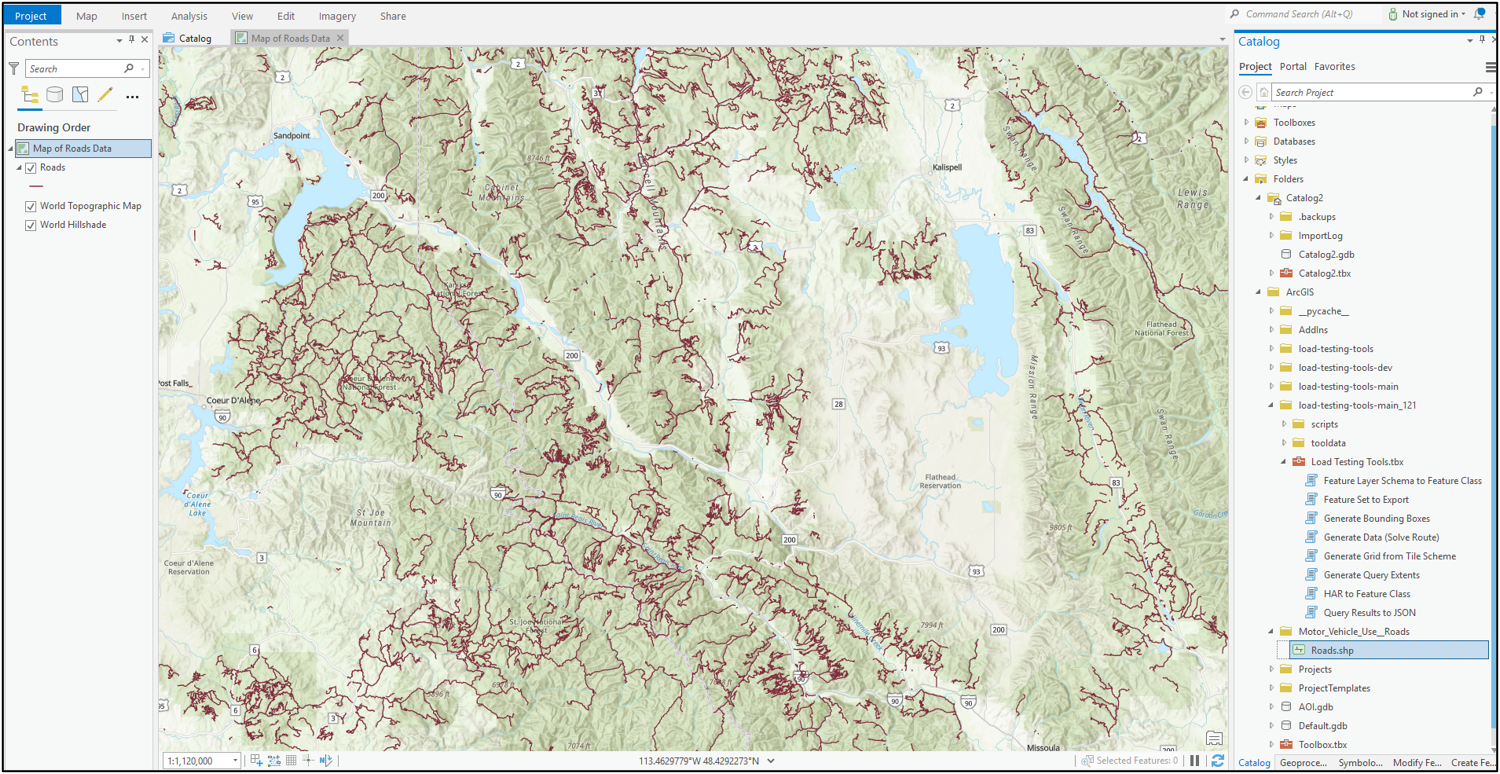

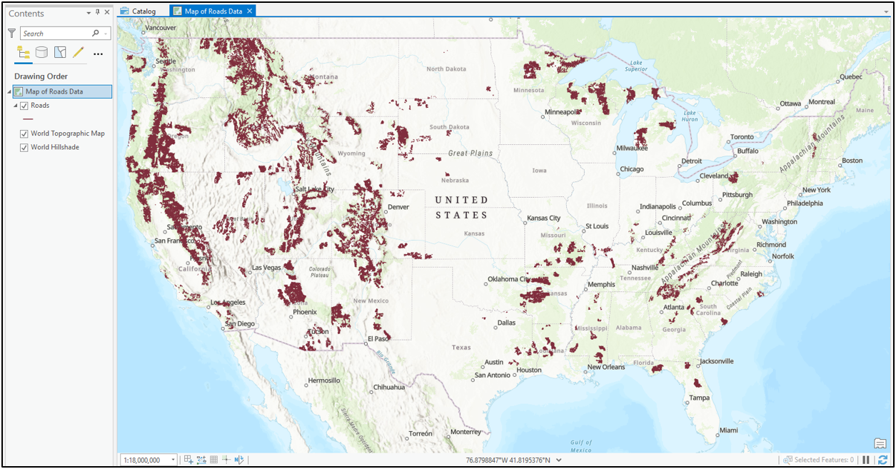

Enter in the Motor Vehicle Use Map: Roads feature layer dataset on hub.arcgis.com. The 179K polyline records of USGS Roads data in WGS 1984 Web Mercator (Auxiliary_Sphere), equates to about 200MB when zipped. It is provided through the Creative Commons (CC0) license.
- View of Roads data from ArcGIS Pro:
- Large scale view with labeling enabled:
This data will be published from ArcGIS Pro to a hosted feature service in ArcGIS Enterprise or loaded directly through Portal for ArcGIS.

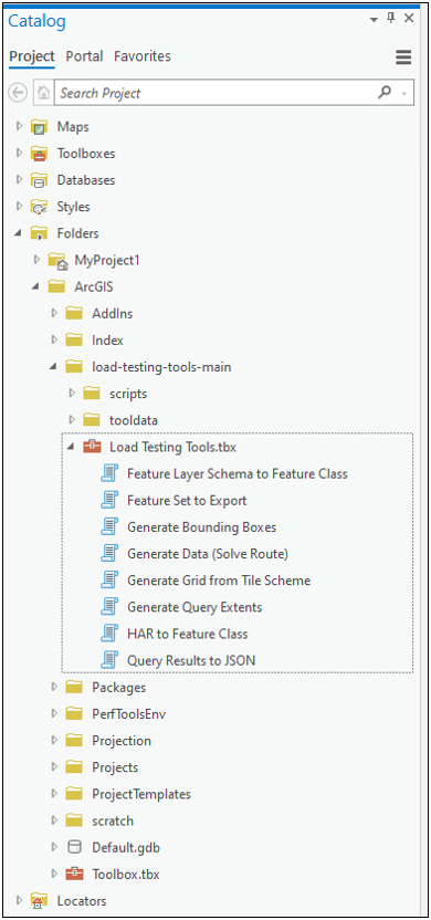

Making the Tools Available from ArcGIS Pro
Once the load-testing-tools project has been downloaded to your machine, place the unzipped folder in a directory that is accessible or made accessible by ArcGIS Pro. If you have a previous version of the Load Testing Tools already installed, this updated version can be installed along side it (although with a different folder name) or completely replace the existing folder.
For example:
- Place the load-testing-tools folder in C:\Users\[username]\Documents\ArcGIS
- Use the Add Folder Connection from Catalog in ArcGIS Pro to list the contents of this directory:

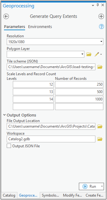

Run the Generate Query Extents Tool
- Running the Generate Query Extents tool should present inputs similar to the following:
Adjust the Inputs for the Generate Query Extents Tool
The default inputs were adjusted to reflect the following:
- Several smaller and larger scale levels were removed
- The remaining scale levels are 12, 13, and 14 which correspond to the map scales 144448, 72224, and 36112, respectively
- The Number of Records for these scales were increased
- Scale Level 14 may be omitted depending on the release of Load Testing Tools (if absent, please add this Scale Level manually)
- The File Output Location which should be something similar to:
- C:\Users\username\Documents\ArcGIS\Projects\Catalog2\query_extents.csv
- Click Run to execute the tool
Note: The duration of time to generate the test data is based on several factors such as the number of different Scale Levels, the Number of Records (per each Scale Level) and the current map scale of the Project.
Note: Generating test data using other datasets may dictate the need to use different Scale Levels based on level of detail and feature density.

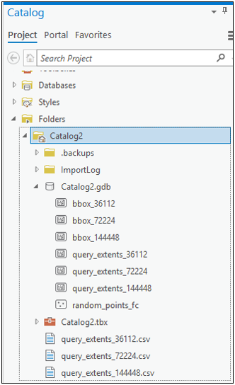

Once the tool has completed successfully it will generate 3 primary sets of data that are of interest:
- Bounding box feature classes
- Contains randomly generated areas of interest
- One feature class for each requested Scale Level
- Query Extent feature classes
- Contains a (512x512) tile grid that each feature query will be based on
- Query Extent CSV files
- Contains the generated test data
- Each line is composed of the dynamic components of a feature service request
- One file for reach requested Scale Level

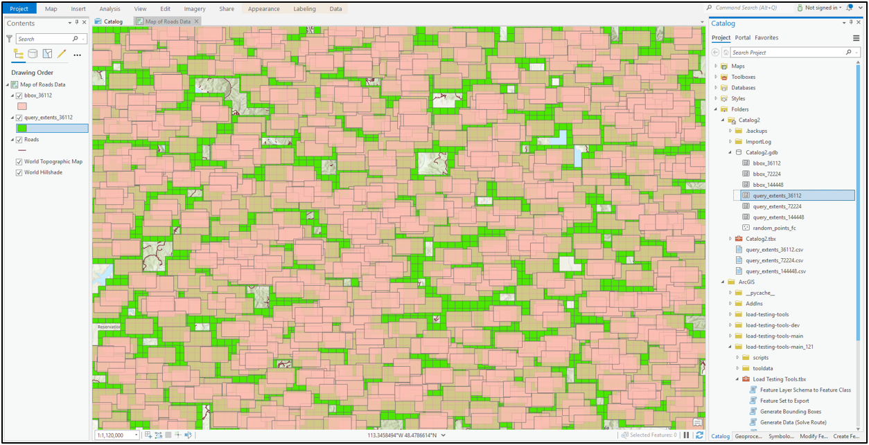

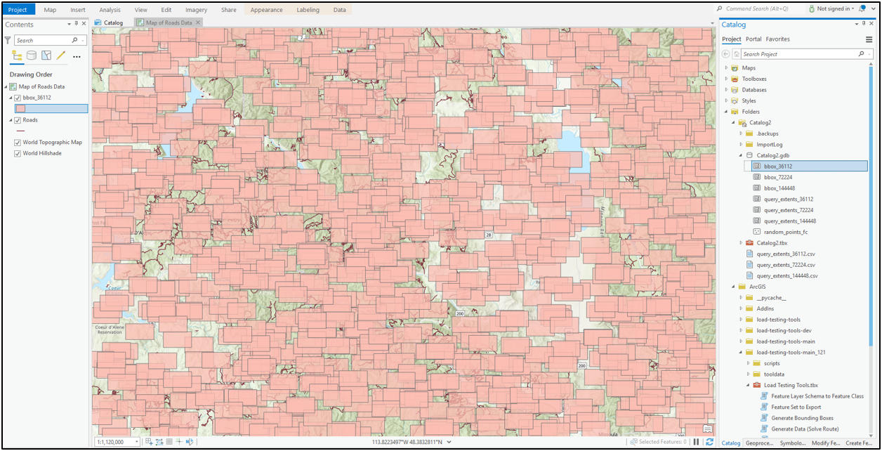

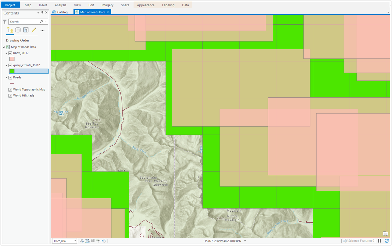

- From the Catalog panel, load the bbox_36112 feature class onto the current map in ArcGIS Pro
- This output is very similar to the data from the Generate Bounding Boxes tool
- In this example, the randomly generated boxes are in pink
- These areas represent the screen resolution of a user requesting data from the feature service

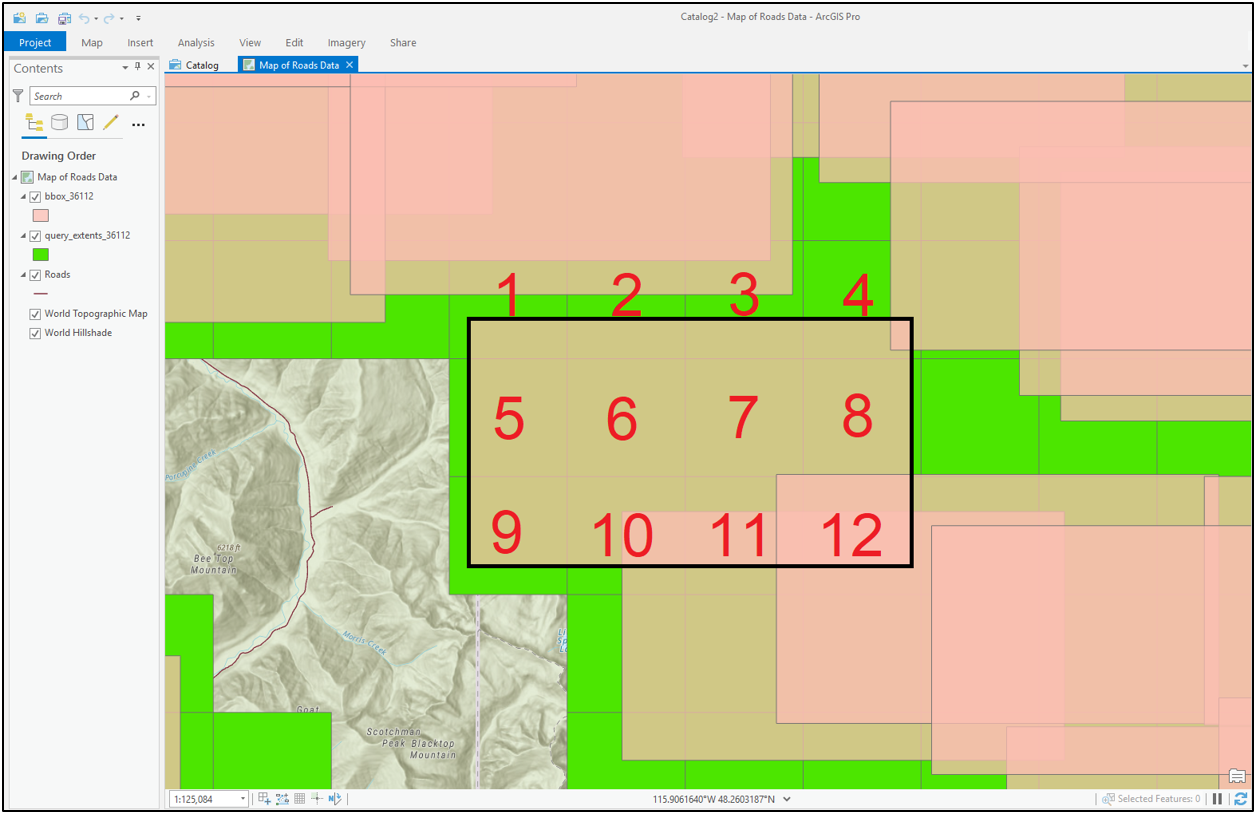

- Now, from the Catalog panel, load the query_extents_36112 feature class onto the current map but behind (underneath) the bbox_36112 data
- In this example, the query tile grid boxes are in green
- These tiles correspond to an area on the map that the bboxes are asking for data
- Zooming in to the map can yield a better understanding to the relationship between these two datasets
- As seen in the map below, some bboxes are slightly offset from each other but still share a common query tile from the grid beneath them
- The coordinates of these query tiles (e.g. from the query_extent feature class) is what will go into the CSV files and ultimately the JMeter load test
- Looking closer at the bboxes reveal details on their respective query composition
- For example, some bboxes might require 12 "underlying" tiles to fulfill, others 15 or 20
- As seen in the map below, the bbox highlighted in black requires 12 specific query tiles colored in red
Note: The tile grid design of the feature service is one of its key strengths as it lends itself to repeatability. This repeatability can be leveraged with caching in a deployment for improved scalability. This is not possible with export map.

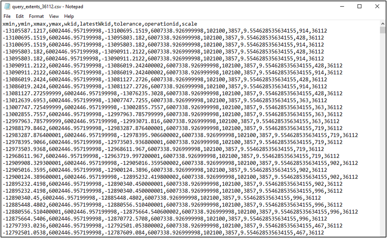

- Examining the generated CSV files will reveal the end results of this transformation
- Viewing the query_extents_36112.csv file in a text editor should show something similar to the following
- Depending on the release of Load Test Tools, the CSV files might be sorted by the operationid column
- Depending on the release of Load Testing Tools, the line may or may not be grouped by the operationid column
- The understanding of the operationid, in this case, is an important testing concept as each operation is representing a navigation action (e.g. a pan or zoom)
- From JMeter's point of view, an operation is the same as a transaction
- All the lines with a matching operationid will become feature service query request geometries under the same transaction controller

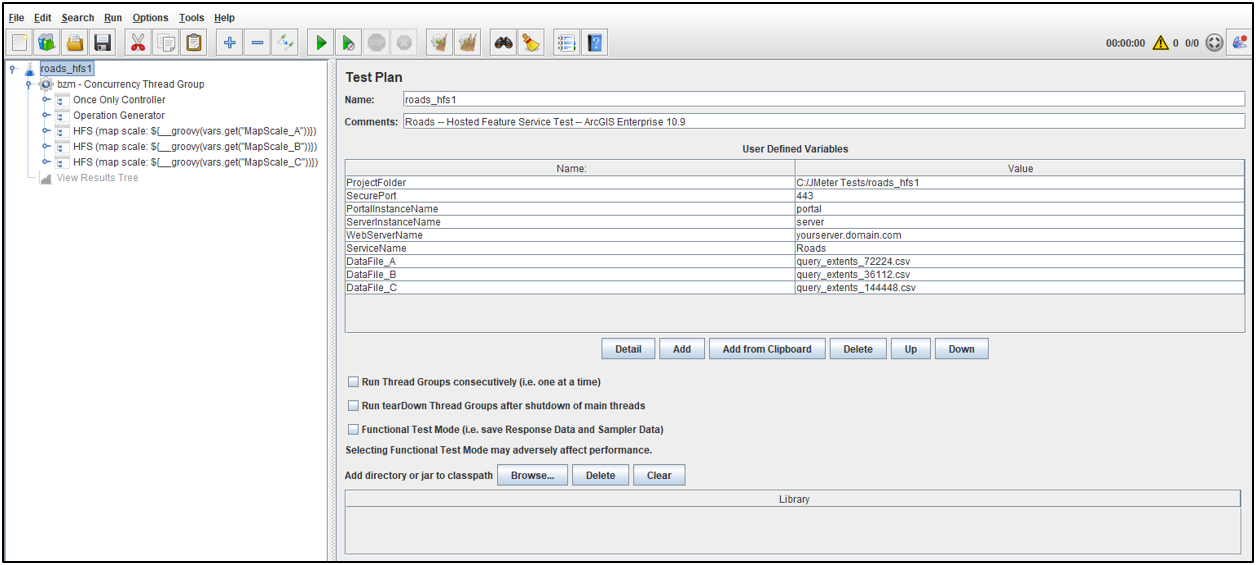

- Opening the Test Plan in Apache JMeter should look similar to the following:
- Adjust the User Defined Variables to fit your environment
- The 3 CSV files generated from the tool are referenced by through the JMeter variables DataFile_A, DataFile_B, and DataFile_C by just the file name (the file system path is not included here)

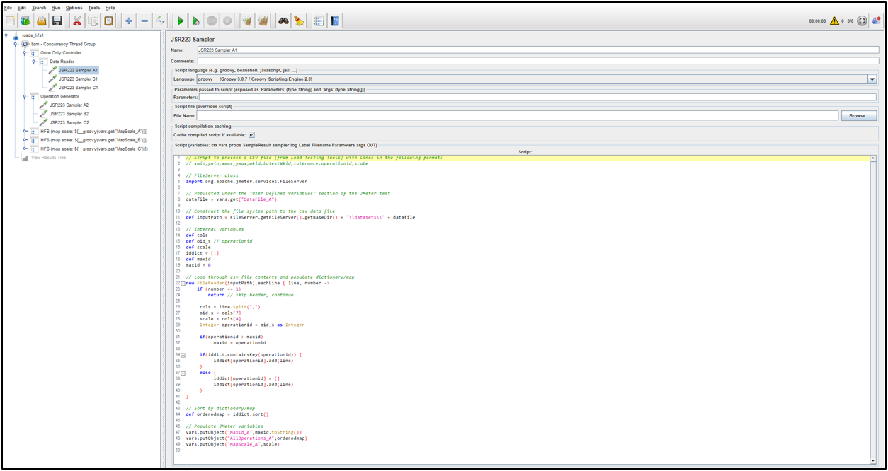

Data Reader Logic
The roads_hfs test is a bit of a different beast than other Apache JMeter test examples used in previous articles. The primary different is that while its still a data drive test (e.g. CSV files are used for request input), it is not using the typical "CSV Data Set Config" Config Element object to read in the data. Instead, this logic is performed through JSR223 Samplers that execute Groovy code. The reason Groovy is utilized is due to the nature of interacting with a feature service mentioned earlier. Recall that some transactions will have 12 requests and other may have 15 or 20 (depending on where the overall area of interest lands on the tile grid). This difference in the number of requests requires the test to use a more flexible mechanism for reading and using the data from the CSV files since this will not be constant.
- There is one JSR223 Sampler for each CSV file (e.g. each map scale)
- All JSR223 Samplers for reading data are put into a Once Only Controller to minimize overhead
- The CSV file read will only be carried out once, at the beginning of each test thread
- Shown below is "JSR223 Sample A1" which will be reading in the file query_extents_72224.csv
- Experience coding in Groovy is not required for running this test, in fact, these JSR223 Samplers do not need to be edited to run the test, but it is helpful to understand what logic is responsible for reading in the CSV data

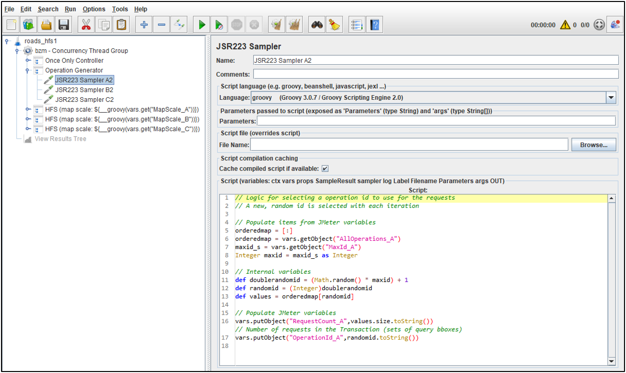

Operation ID Selection Logic
Once the CSV data has been read in, the test will need to select an operation id for each scale with every test iteration. To accomplish this, a second set of JSR223 Samplers were used to pick from each list of operations.
- There is one JSR223 Sampler for each map scale that randomly selects an operation id
- All JSR223 Samplers for generating this operation id are put into a Transaction Controller called Operation Generator
- This is executed with every test thread iteration
- These JSR223 Samplers do not need to be edited to run the test
Note: JSR223 Samplers using Groovy are generally executed quickly and add very little overhead to the test

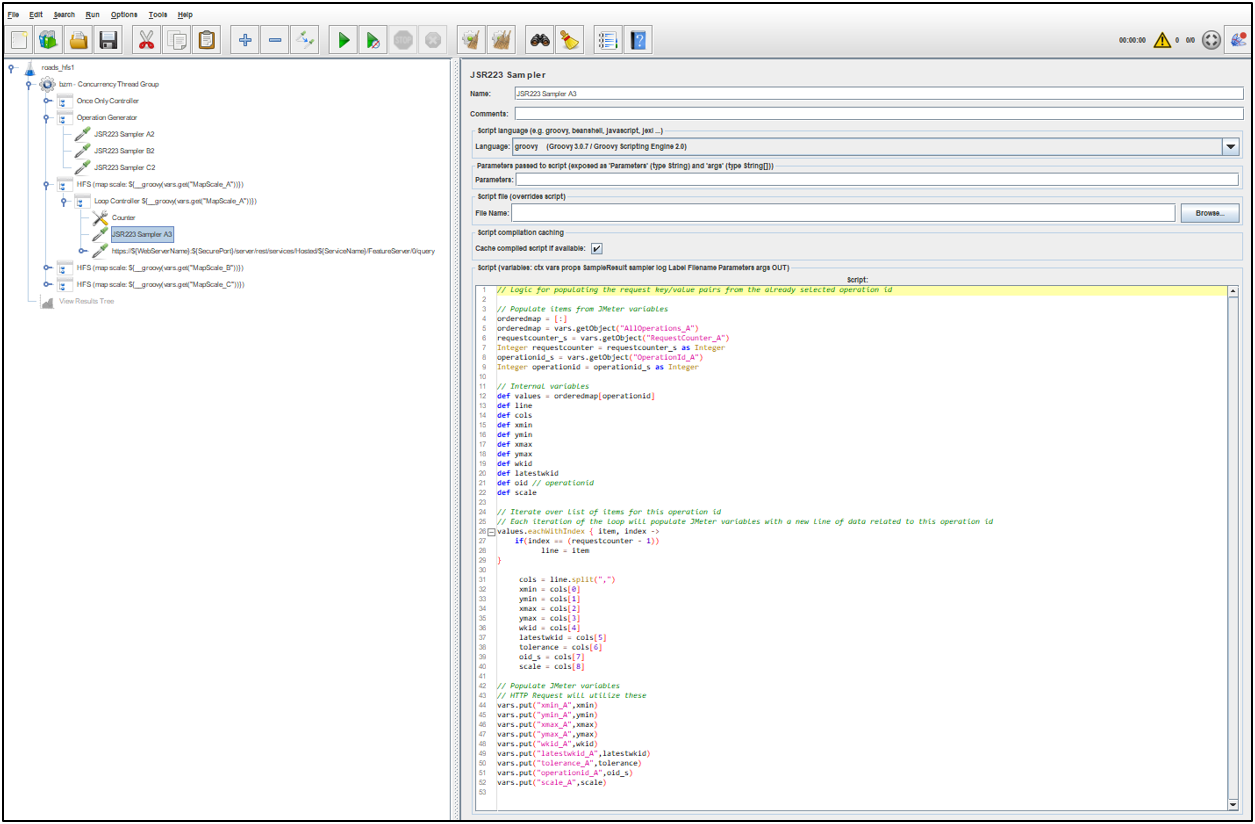

Operation Loop and Parameter Population
With an operation id chosen, the focus becomes the loop logic where the test will lookup the number of feature services queries that the make up the transaction. From there it will use a third set of JSR223 Samplers to populate the requests parameters associated to the previously selected operation id with each iteration in the loop.
- There is one JSR223 Sampler for each map scale that populates the associated JMeter variables based on the operation id and iteration value
- These items then become key/value pairs which are picked up by the HTTP Request
- The iteration valued are tracked by a Counter Config Element
- Each Loop Controller, Counter, JSR223 Sampler and HTTP Request objects are all placed inside a corresponding Transaction Controller to logically separate the items for each map scale

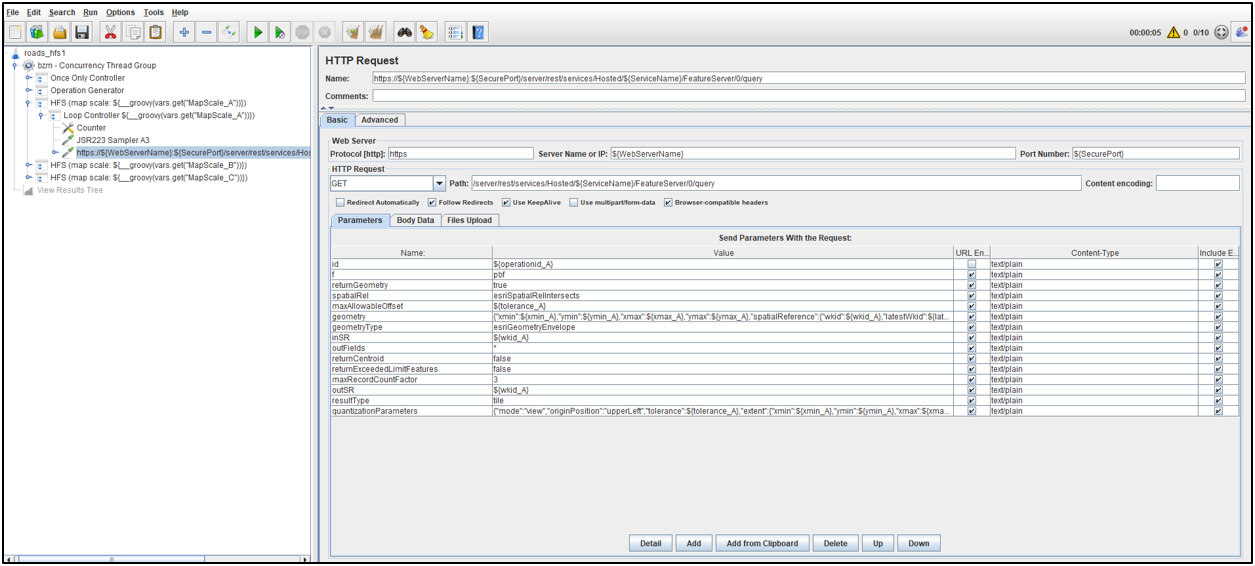

HTTP Request
Essentially, all of the test logic above exists just for this component of the test. Here, the JMeter HTTP Request object can read-in the JMeter variables for specific key/value parameters that have been populated by the JSR223 Sampler immediately before it.
Since this approach is highly programmatic, there is only one HTTP Request per map scale! Such a design favors maintainability.
Note: This test approach would also work for traditional, non-hosted feature layer services. However, these feature services do not have the same request parameter optimizations that hosted services do such as maxAllowableOffset and quantizationParameters. These options would just need to be deleted from the HTTP Request.

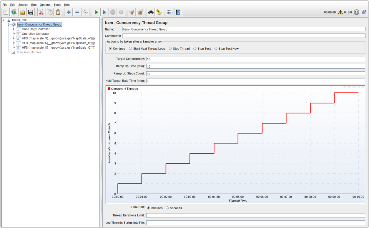

The Thread Group Configuration
The JMeter Test Plan is currently configured for a relatively short test of 10 minutes. Generally speaking, hosted feature services perform well, so a lot of throughput will be taking place within each step (1 minute per step) as well as from the test overall.
- Different environments and data may require an alternative setting to achieve the desired test results, adjust as needed

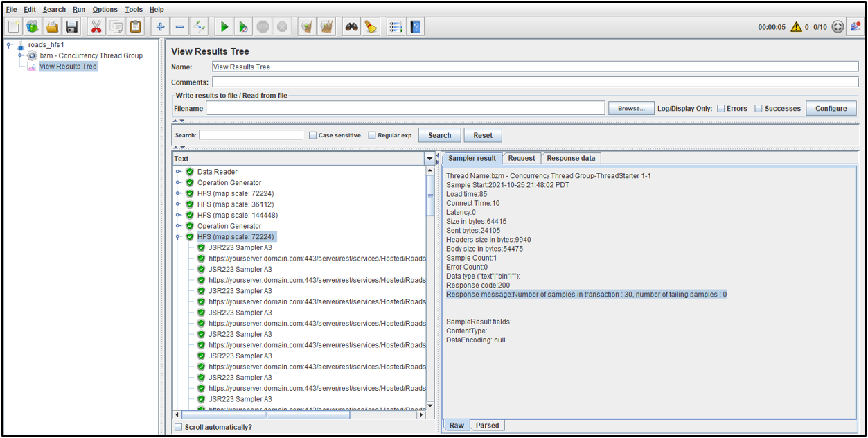

Transactions
- Select one of the "HFS" Transactions
- The results should resemble the following:
- In this example, the transactions listed above: HFS (mapscale: 72224), HFS (mapscale: 36112), and HFS (mapscale: 144448) all completed successfully
- The Sampler result lists some more details
- Although each Transaction sent one HTTP request per feature query extent, the JMeter test is counting the Sampler as part of the operation
- The JSR223 Samplers add very little overhead to the Transaction although they do double the number of samples, this is just a detail to be aware of
- Take a quick glance at the Size in bytes
- In this example, the Transaction Size was almost 65KB which suggests some data was being returned and the responses were not "empty"

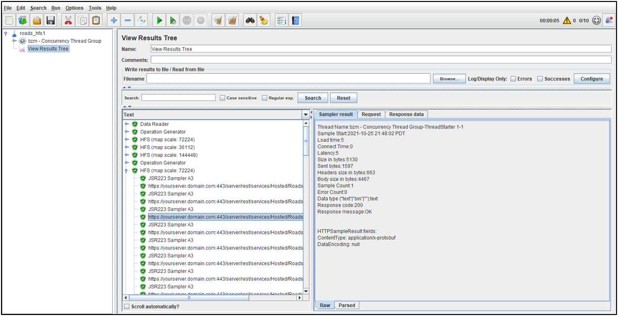

Requests
- Expand one of the "HFS" Transactions
- Select one of the https requests
- In this example, the select request completed successfully
- In this example, the Request Size was about 5KB which suggests some data was being returned and the responses were not "empty" (e.g. 1500 bytes)
- The ContentType is also important
- Per the parameters in the Test Plan, the requested format is pbf which returns application/x-protobuf
- Requesting protocol buffers is a best practice as it optimizes the payload
- The resulting format is binary and cannot easily be viewed without additional help that is not covered in this Article
Note: Feature services (including hosted feature services) are rendered on the client (not on the server like export map). Although Apache JMeter is a (test) client, it does not render the server responses through JavaScript like a web browser.

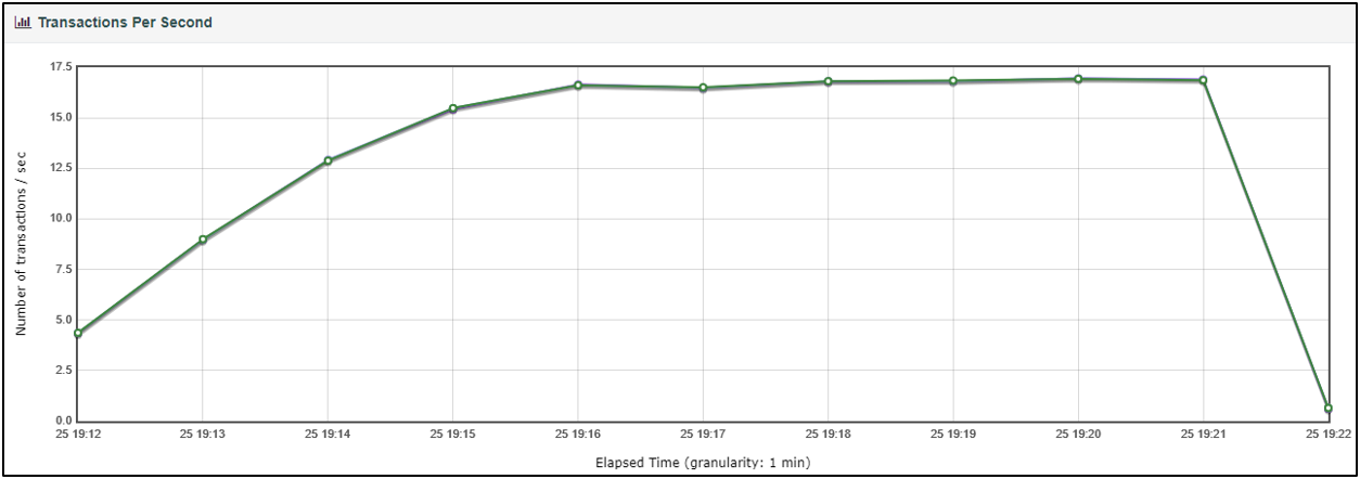

Throughput Curves
- The auto-generated JMeter Report can provide insight into the throughput of the HFS transactions under load
- Non-HFS Transactions have been manually filtered out
- In this case, the peak throughput for the HFS operations was about 16.5 transactions/second
- Since there were 3 HFS transactions, this equates to almost 50 transactions/second (or 178,200 transactions/hour)
Note: Each of the HFS Transactions will naturally have a similar throughput as their respective execution in the test was weighted the same

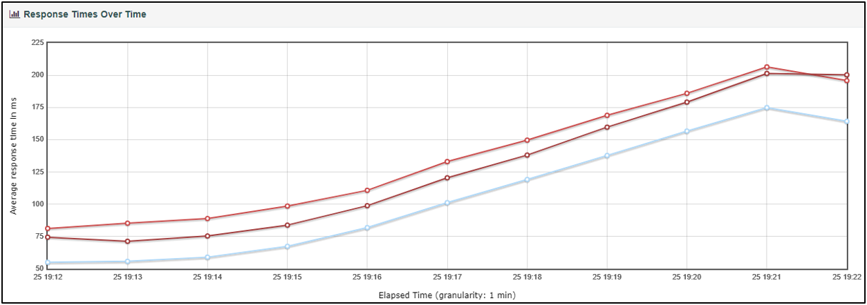

Performance Curves
- The auto-generated JMeter Report can provide insight into the performance of the HFS transactions under load
- In this case, HFS transactions for all scales were sub-second (under 1 second)
- Even toward the end of the test, under the heaviest load, the average response time was under 225 ms or 0.225 seconds
