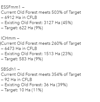

This is how my data (feature:standalone table, 1:Many) is currently displayed. Unfortunately, it is quite clunky/busy, and without being able to apply any HTML formatting via Arcade it's difficult to improve the user experience:

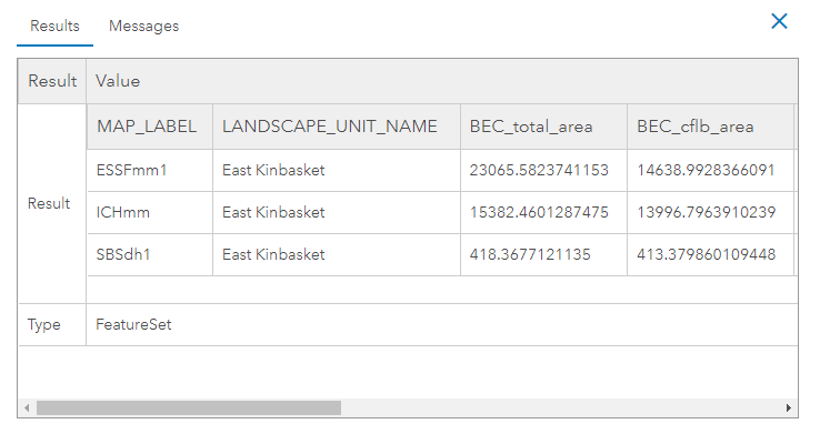

Within Arcade, however, it is possible to return a table object. For example:
Unfortunately, this table object is not viewable within a pop-up (this is Map Viewer; Map Viewer Classic is simply blank):
