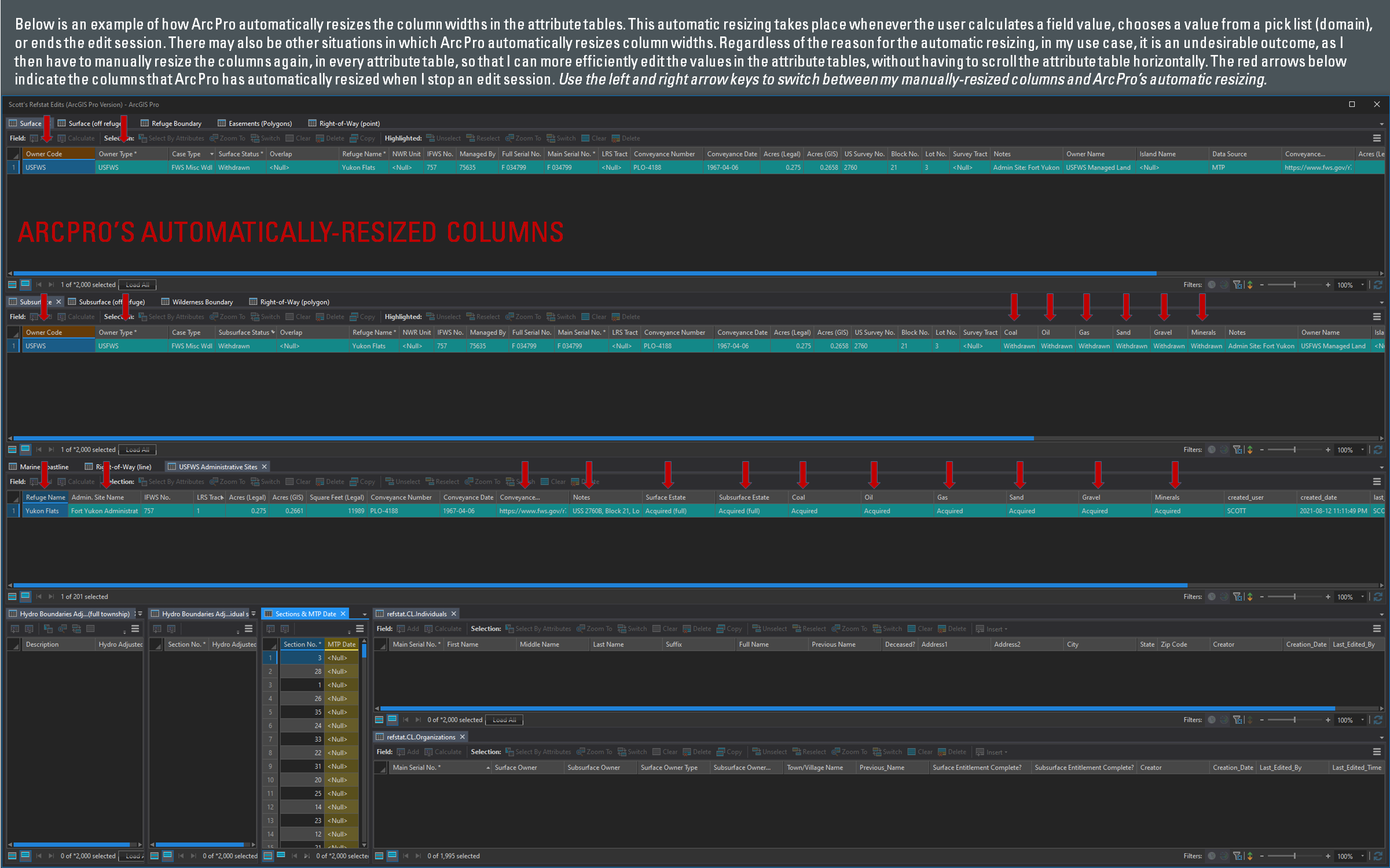

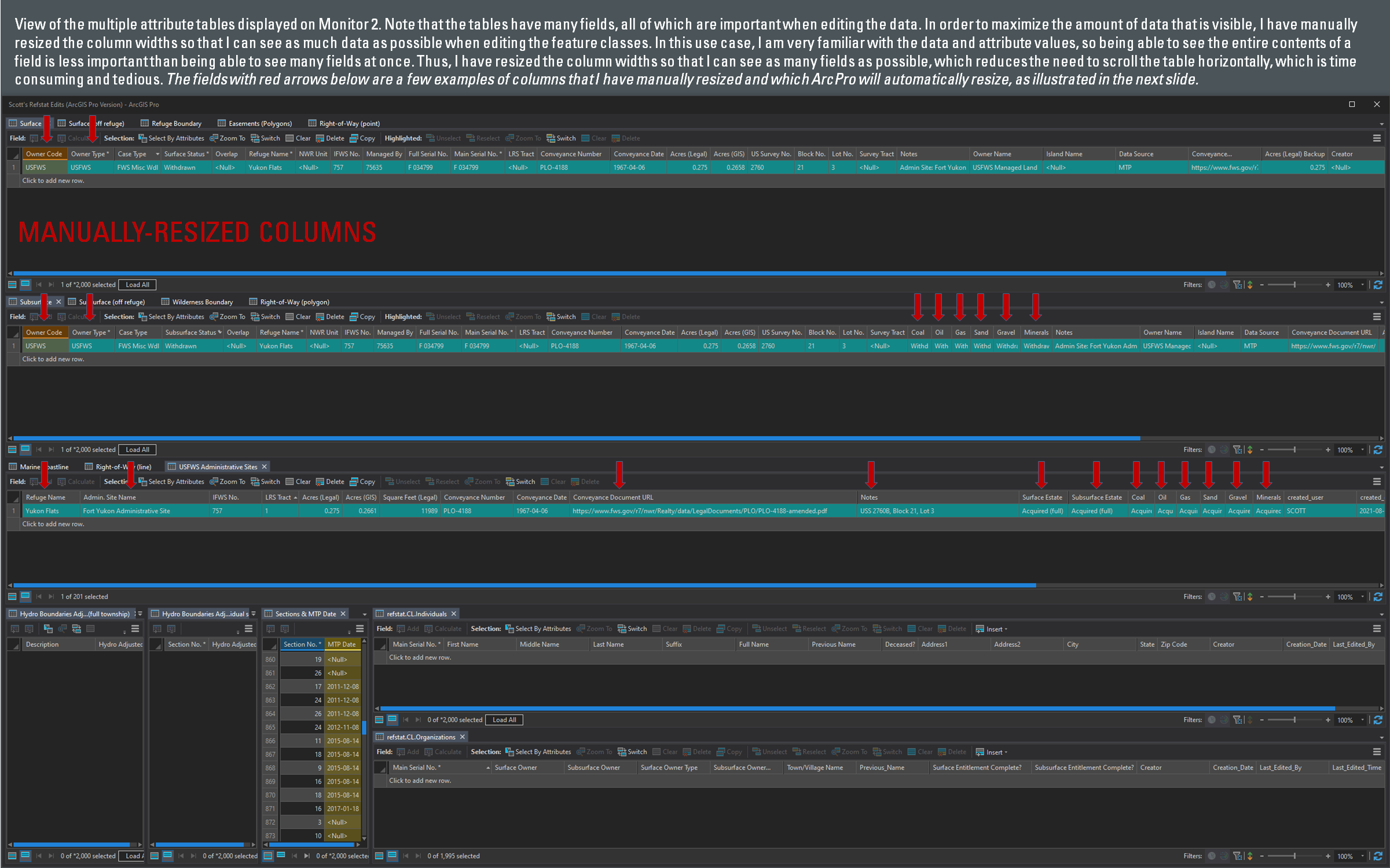

Below are two screenshots that illustrate the auto-resizing issue. The first screenshot shows attribute tables in which I have manually resized the columns in order to optimize the number of fields that I can see without having to scroll horizontally. The second screenshot shows the attribute tables when ArcPro automatically resizes the column widths.
