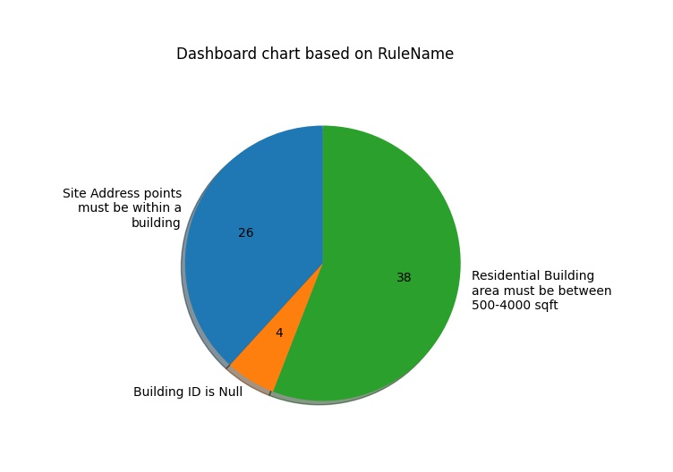

Dashboard charts
Attribute rules allow you to evaluate a feature’s quality based on requirements implemented as a series of validation rules. Evaluation is done on an as-needed basis either interactively using the Error Inspector in ArcGIS Pro, as a step in an automated workflow using the Evaluate Rules geoprocessing tool, or using Evaluate REST operation. Error features are created when a feature fails to meet the criteria implemented in the validation attribute rule.
In this example, error features are leveraged using ArcPy to provide a dashboard chart that summarizes error information based on a field. Some of the common fields include the error lifecycle phase or status, severity, or rule name. First, the script queries all error layers in the geodatabase based on the provided field. Once the geodatabase path and a field name are passed in the “make_combined_list” function, it returns a list of error results:
Note : This script uses the Matplotlib python library available with ArcGIS Pro.
def make_combine_list(gdb, field):
Occurances = []
with arcpy.da.SearchCursor (gdb + "\\GDB_ValidationPointErrors", field) as cursor:
for row in cursor:
Occurances.append (row[0])
with arcpy.da.SearchCursor (gdb + "\\GDB_ValidationLineErrors", field) as cursor:
for row in cursor:
with arcpy.da.SearchCursor (gdb + "\\GDB_ValidationPolygonErrors", field) as cursor:
for row in cursor:
with arcpy.da.SearchCursor (gdb + "\\GDB_ValidationObjectErrors", field) as cursor:
for row in cursor:
return Occurances
Once the list is created with all the results combined at one place then we find the unique count and values based on those results. These values are then used to label the dashboard chart. The “get_unique_count” functions take two parameters, a list and a bool if count required “true” or “false” and returns a list of unique values if bool is false and a list of count of unique values if bool is true:
def get_unique_count(list, Is_Count):
unique_values = []
count = []
for i in list:
if i not in unique_values:
unique_values.append(i)
for i in unique_values:
count.append (list.count(i))
if Is_Count == True:
return count
else:
return unique_values
If the field value is “Error status”, which uses a coded value domain, the codes must be replaced by the description value to get a better understanding in the chart. To do this, we pass the list of unique values to replace function and it will return a list with the description value. This logic can be used with any coded domain value field i.e. Life
def replace(list_unique_values):
for i in range(len(list_unique_values)):
if list_unique_values [i] == 1:
list_unique_values [i] = "Reviewed"
elif list_unique_values [i] == 2:
list_unique_values [i] = "Resolved"
elif list_unique_values [i] == 3:
list_unique_values [i] = "Mark As exception"
elif list_unique_values [i] == 4:
list_unique_values [i] = "Acceptable"
elif list_unique_values [i] == 6:
list_unique_values [i] = "Unacceptable"
elif list_unique_values [i] == 9:
list_unique_values [i] = "Exception"
return list_unique_values
Once we get the unique field values and counts, we pass this info to the Matplotlib object to draw the chart.
