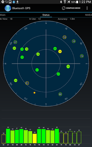

- Many handheld GNSS/GPS receivers support tracking satellite positions in 2D
- Satellite positions are typically given by `$GPGSV` sentences in NMEA specs, in the format of elevation and azimuth angles

Many handheld GPS receivers more or less support viewing the satellite information. On some devices, they show up as a series of signal bars; on other devices, two concentric circles are used to depict the earth and the orbit, and the satellites are plotted on that graph. These graphics are OK, but neither intuitive nor informative.
The positions of satellites are represented by elevation and azimuth angles in `$GPGSV` sentences in the NMEA specs. What are these? In short, azimuth tells us what direction to face, and elevation tells us how high up in the sky to look. Think of a person standing on the ground, holding both a GPS receiver and a compass. Turning around from the north and raising the head, one can eye into the approximate direction of the satellite in the sky with these 2 angles. However, when it comes to mapping software, things get a bit trickier.

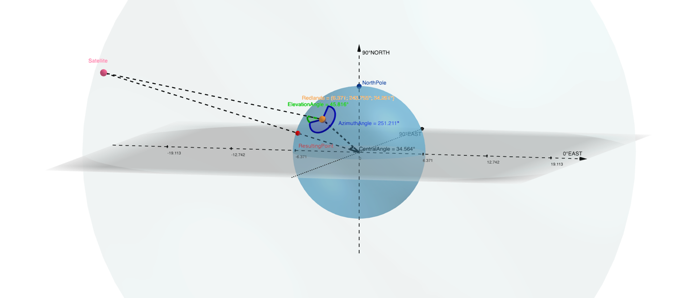

The Quest to Find “The 3rd Axis”
So far, I've figured out how to use quaternions to facilitate the calculation. From the unit vector to the lat-lon vector, we did 2 rotations using y-vector and z-vector as the first and second axes. To get our resulting satellite vector though, we need a third axis to incorporate azimuth and elevation angles.

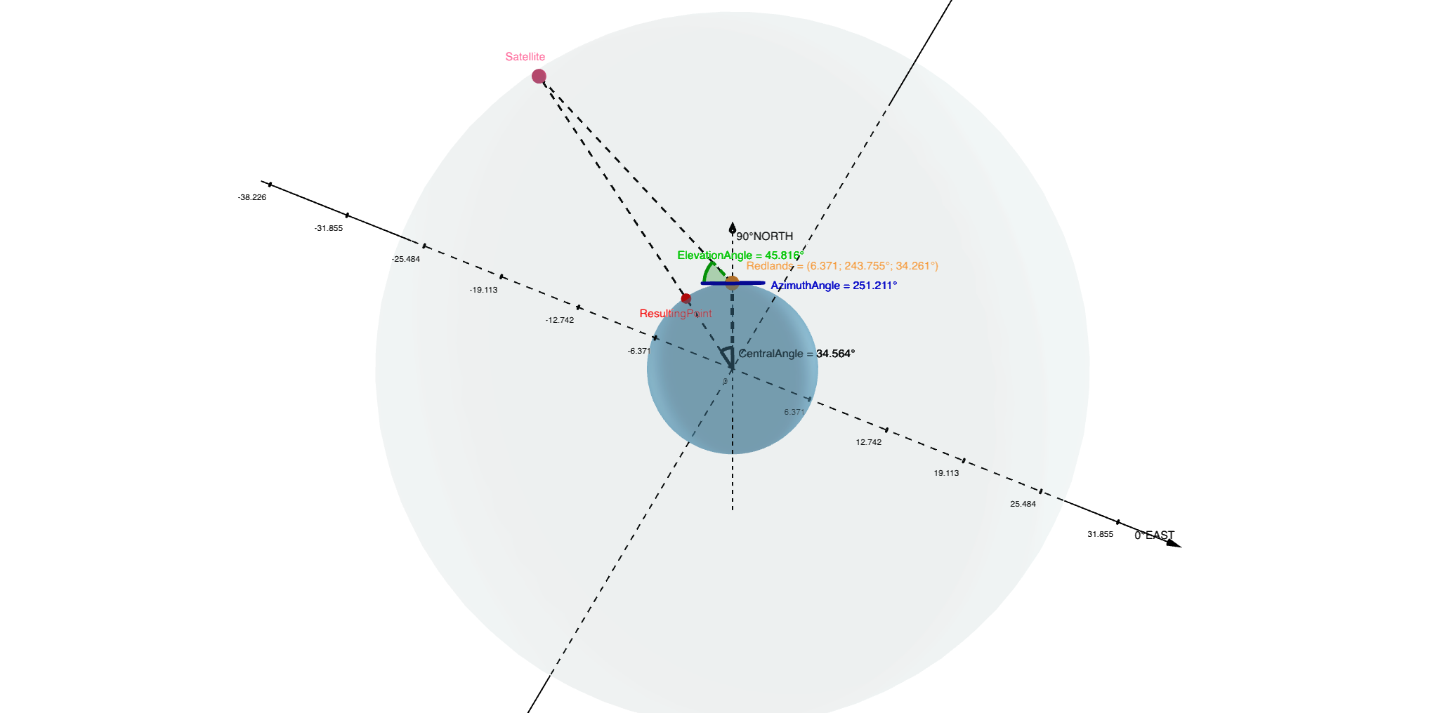

This is the trickiest part of math for this problem. To get there, we'll need to rotate a vector according to the elevation angle. That vector itself needs to be rotated from another vector by the azimuth angle. And I'm calling this vector the 3rd axis.
It’s hard to describe it in words, so I drew it all on GeoGebra. Toggle the graphics on the left pane to see their spatial relationships.
With 3 axes, 4 quaternions and all the mysterious steps, how to ensure the result is correct? Luckily again, with the visuals created on GeoGebra, I can get the azimuth and elevation values reversely, by specifying the other parameters, namely latitude, longitude, earth radius and orbit radius. So, if my calculation is correct, the resulting satellite coordinates should be the same as on GeoGebra.

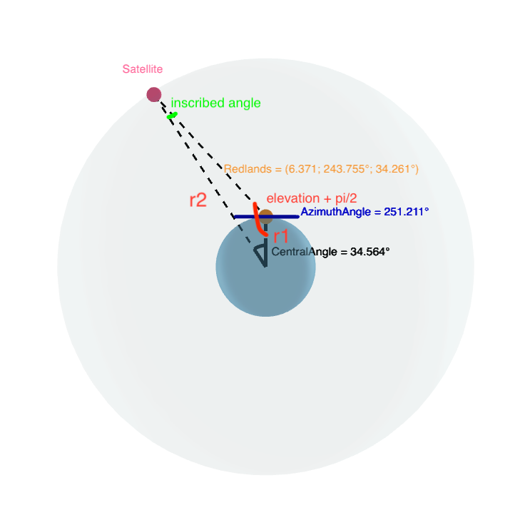

// 1. Basic trigonometry
let r1 = earthRadius
let r2 = r1 + satelliteAltitude
let elevationAngle = radians(from: elevation) + .pi / 2
let inscribedAngle = asin(r1 * sin(elevationAngle) / r2) // Law of Sines
let centralAngle = .pi - elevationAngle - inscribedAngle // Internal angles sum = pi

It can be split into 3 parts - basic trigonometry, quaternion rotation and coordinate system conversion.
First, as described above, we need to do some basic trigonometry on the "elevation plane", i.e. the plane where the elevation angle exists. Using Law of Sines, we can get the value of the central angle, assuming both the earth radius and the satellite orbital distance are constants.
Second, do the rotations.
- Rotate the x unit vector (0° East) to get the `latLonAxis` vector, which starts at the center of the earth, and ends at our longitude and latitude on the earth surface (lat-lon position).
- In order to find the axis for the elevation angle rotation, we need to first create the `thirdAxis` - which is a vector that runs perpendicular to the rotated azimuth vector. The azimuth vector itself, is a line on a tangent plane of the earth (which the point of tangency is the lat-lon position) that, by definition, starts at the lat-lon position and ends at 0° North, which intersects with the z axis.
- Ensure the sign of these angular values match the direction of rotation.

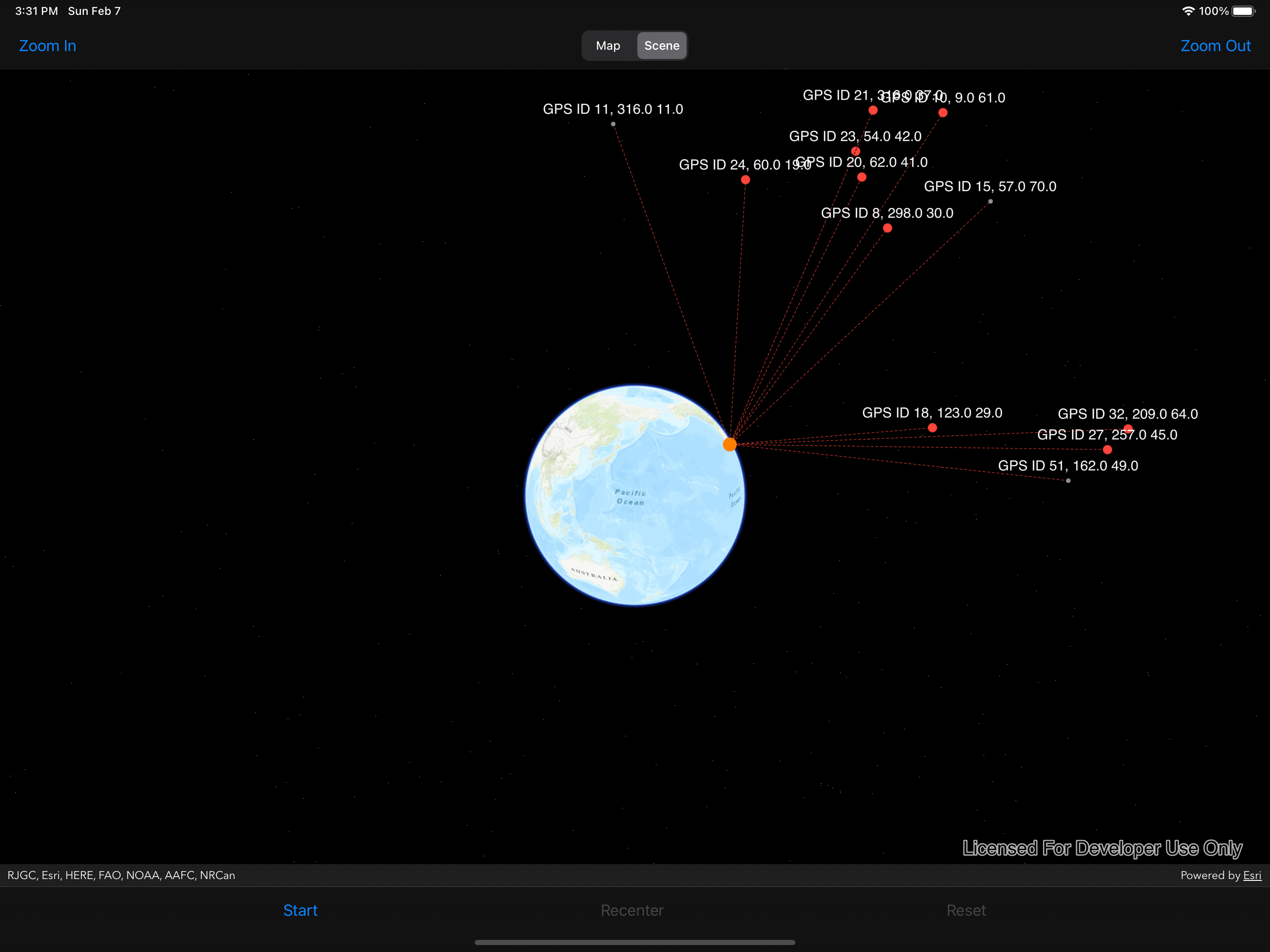

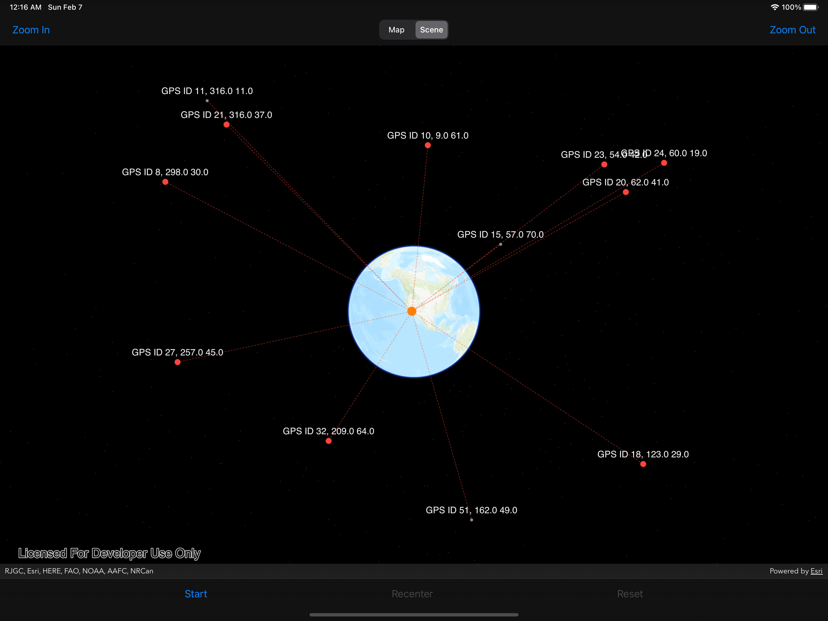

Create the Visuals with ArcGIS Runtime
With the powerful scene view APIs in ArcGIS Runtime, we can display spatial graphics in 3D with ease. One can even draw the satellites with 3D models, but here I just use red and gray dots. Combining with other APIs, within a few lines of code, we can draw the current lat-lon position as well as all the satellites in the sky, in real time.

Whoa! At first, I thought it was a simple problem, but it results in this long-winded article that tries to explain every aspect of the process. The optimized core algorithm is short and sweet - with only 2 quaternions, it would be very unlikely to have an even simpler way to get these satellite coordinates.
The resulting graphics are elegant and beautiful. When I first revealed the screen recordings, people are responding with starstruck emojis 🤩. To be fair, who won't be curious to see them in a perceivable graphical representation, rather than the abstruse numerics? Personally, I love the fact that these satellites are just there, orbiting above our heads and working tirelessly to connect everyone, everywhere.
