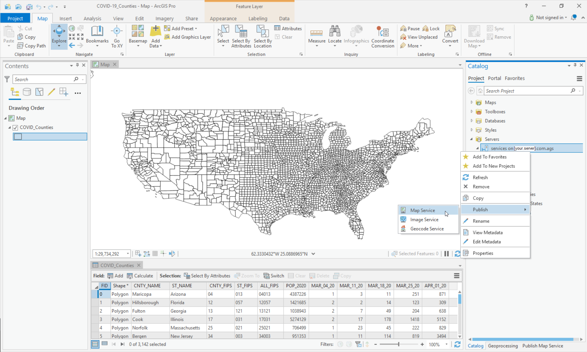

Using ArcGIS Pro, I created a shapefile (named COVID_Counties.shp) based on the USA county boundaries. The attribute data contained the following fields for each USA county:

I set the fill for the county boundaries to be transparent and the outline to be 0.5 pixel wide. Then with with the Catalog tab active, I right clicked on the name of the ArcGIS Server I had administrative access to and chose Publish > Map Service.
In the first dialog that appears in the publish process, Select Map, I expanded the left Project > Maps TOC item and chose Map (which is the view that had my data COVID_Counties.shp layer) . Then, I clicked OK.
Afterward, the Publish Map Service tab became active and I proceeded to fill in all of the necessary elements to publish my map as a service. In particular, I specified the following options:

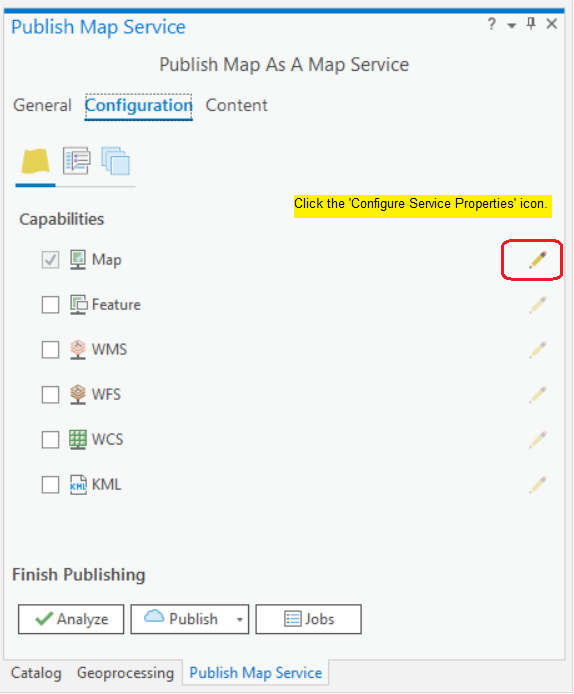

General tab
Configuration tab
**NOTE: Click the Configure Service Properties icon.

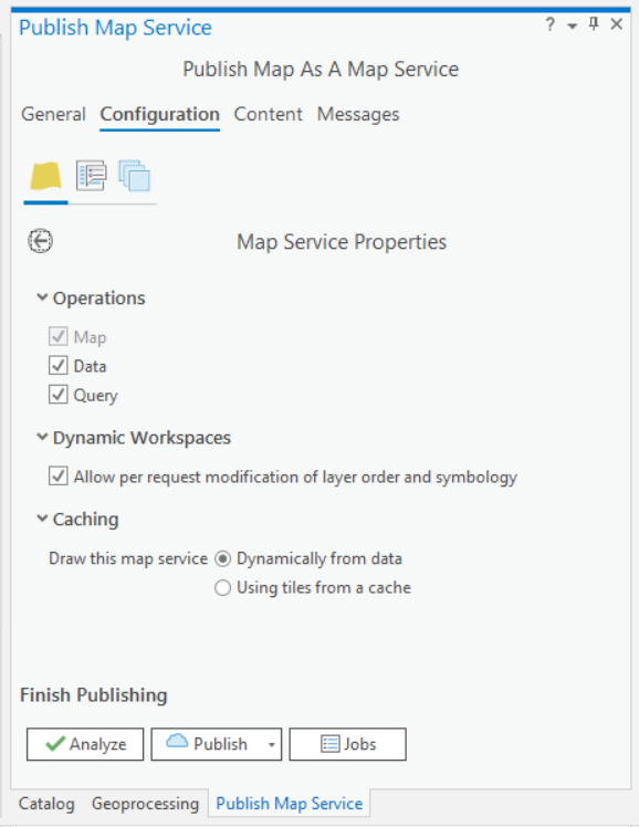

Then, I made sure the following Map Service Properties were set:
Operations
| Map | checked on |
| Data | checked on |
| Query | checked on |
Dynamic Workpaces
| Allow per request modification of layer order and symbology | checked on |
Caching
| Draw this map service | Dynamically from data |
As a good practice it is recommended to click the Analyze button before trying to Publish your service, to fix any errors or warnings. After I had everything the way I wanted, I clicked the Publish button and waited for the "Successfully published map service....." notification. So far so good.

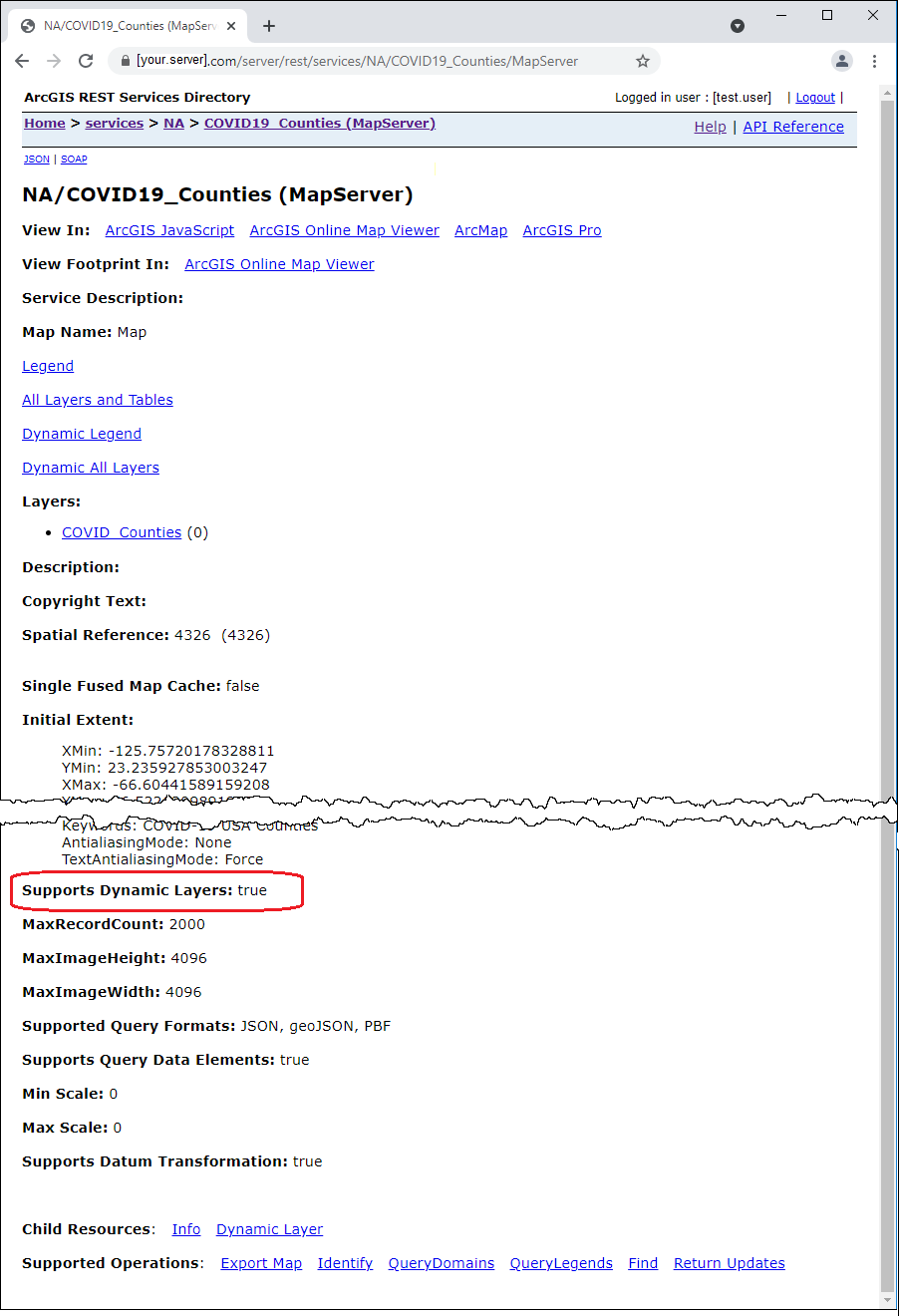

Now let's move to ArcGIS Server to ensure that I could see what I was expecting. I logged in with my username and password. I navigated to the correct location where my newly publish map was. In my case the COVID19_Counties (Map Server) was there and had the following configuration:
The most important thing I was looking for was the Supports Dynamic Layers: true setting. This ensures that we can generate a dynamic map layer in ArcGIS Server.
TIP: In general, when you see the Support Dynamic Layers: true setting on any ArcGIS Server service REST page out on the open internet, you can create a dynamic map layer in your custom app. It does not matter who is the author or publisher of these services; they are public and you can explore and tinker as you wish.

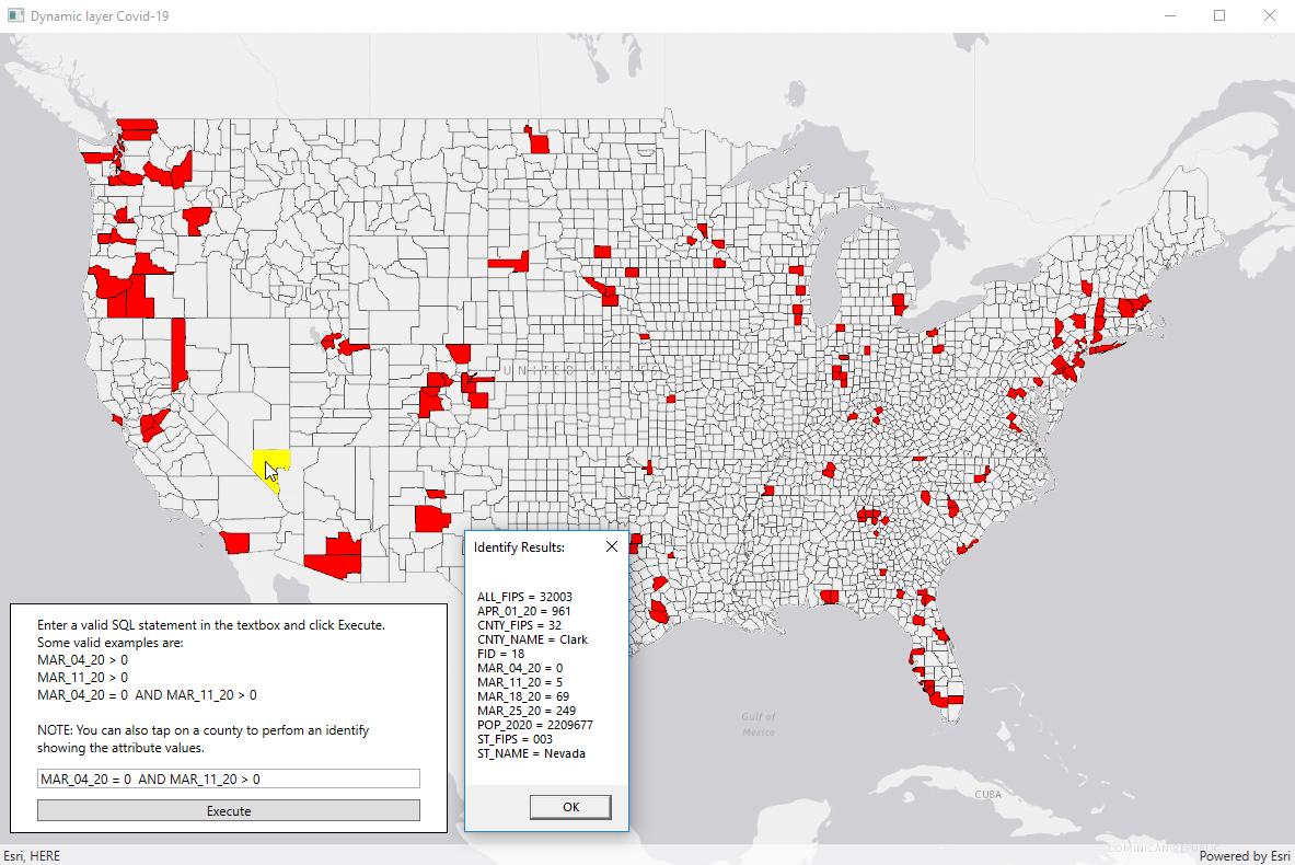

This file contains the main logic for the running of the app. There are 4 main sections worth discussing to provide insight on how the app works:
(1) The using statements at the top of the file shorten the syntax for writing the code.
(2) The IntializeMap() function sets up the initial look of the GUI. It adds the world light gray base map zoomed to the area of the continental USA to provide orientation for the operational layers. An ArcGISMapImageLayer is added by default to show the county boundaries (via transparent fill) used to interrogate COVID-19 cases for few dates in time. A default GraphicsOverlay is created to aid in the identify process. Finally, the GeoViewTapped event is wired up to handle the user map taps to obtain the identify results.
(3) The Button_Execute_Click() function provides the logic to add a dynamic map layer to the application showing USA county COVID-19 cases for selected dates are shown with a red solid fill. The dynamic map layer is created via the MapSubLayerSource object to create an ArcGISMapImageSubLayer object. The user provided SQL syntax is used for the DefinitionExpression to restrict which counties are provided by ArcGIS Server back to the client app. A SimpleRenderer is used to define a solid red fill for those polygons returned. The dynamic map layer is attached as an ArcGISSubLayer of the ArcGISMapImageLayer when the app was first loaded. The function provides logic to remove an prior added dynamic map layers for multiple SQL queries executed by the user.
(4) The MyMapView_GeoViewTapped() function provides attribute information on the dynamic map layer in the map where the user taps. The existing GraphicsOverlay is obtained and cleared from previous user interaction. Using the IdentifyLayersAsync method the IdentifyLayerResult object is returned and SubLayerResults are obtained. While iterating over the results, the GeoElement is obtained and used to construct a yellow solid fill. It is then added to the GraphicsOverlay. Additionally while iterating over the results, the attribute information is obtained. By iterating over the Attributes the Key/Value pairs for each identified county, the results are present back to the user in a MessageBox.

TextBlockInstructions.Text = "Enter a valid SQL statement in the textbox and click Execute." +
System.Environment.NewLine +
"Some valid examples are:" + System.Environment.NewLine +
"MAR_04_20 > 0" + System.Environment.NewLine +
"MAR_11_20 > 0" + System.Environment.NewLine +
"MAR_04_20 = 0 AND MAR_11_20 > 0" + System.Environment.NewLine +
"NOTE: You can also tap on a county to perfom an identify showing the attribute values.";
// Give a starting example of a valid SQL syntax
TextBox_SQL.Text = "MAR_04_20 = 0 AND MAR_11_20 > 0";

After the code complied without any errors, it was time to test out the app. When the app opens you can start out by clicking the Execute button and a dynamic map layer will be generated for the SQL query 'MAR_04_20 = 0 AND MAR_11_20 > 0'. Those USA counties that had 1 or more new COVID-19 cases between March 4, 2020 and March 11, 2020 were displayed in red. This can be verified by tapping on a red county (aka an identify operation) to see the attribute information displayed in a MessageBox as well as that county being highlighted in yellow.
You can experiment further by performing additional 'What if' type of SQL queries by entering them in the TextBox and clicking the Execute button.
