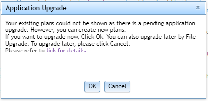

When you log into the redistricting application for the first time after the upgrade has been pushed out, you will see a message like this.
If you have been assigned the facilitator role (or a role with more permissions), clicking Ok will upgrade all of your plans. If you click cancel, you will not be able to open any previously made plans, but will be able to create new plans. If you do not have a role of a facilitator role or higher, a window will appear informing you that you must contact an administrator and have them assign you the facilitator role.

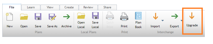

You can upgrade at any time by clicking the upgrade button under the File Tab, shown below.

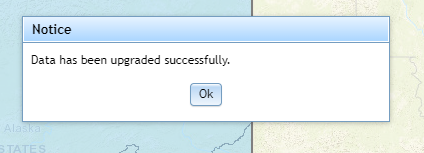

Once the upgrade has been completed, you will get a note that your plans have been successfully upgraded. A text file will also appear in your downloads folder with a more descriptive log of the upgrade.
You may need to refresh the application for the upgraded plans to appear in your plan window.
It is also important to note that the Upgrade Button will remain on the file tab, even if you have upgraded the application. You do not need to go through the process a second time.
