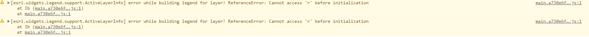

When using ES Module @Anonymous User/core 4.18.1 for angular project, Legend with visual variable was not rendered properly.
The legend worked when doing in memory build. But when doing production build by issuing command
ng build --configuration=production
the legend didn't show and this error was shown on Chrome console.
Step to reproduced the error
1) Create new project by using latest angular cli
ng new my-project
cd my-project
ng generate c map-test
2) Add this simple code to add legend with visual variable
esriConfig.assetsPath = '/assets';
const map = new Map({
basemap: 'topo-vector'
const view = new MapView({
map: map,
container: 'map-container',
center: [-84, 32],
zoom: 5,
constraints: {
rotationEnabled: false
const renderer: any = {
type: 'simple',
symbol: {
type: 'simple-marker',
outline: {
width: '0px'
visualVariables: [{
type: 'color',
valueExpressionTitle: `Legend Title`,
field: 'some_field',
stops: [{
value: 0, color: '#ff0000'
value: 20000, color: '#0f0'
const legendLayer = new FeatureLayer({
source: [],
fields: [{
type: 'oid'
opacity: 0.5,
listMode: 'hide',
objectIdField: 'ObjectID',
geometryType: 'point',
title: 'My legend',
visible: true
legendLayer.renderer = renderer;
map.add(legendLayer);
const legends = new Legend({
view: view
view.ui.add(legends, {
position: 'bottom-right'
}); 3) run production build
PS. I tested using latest angular version (11) as well as angular version 8
